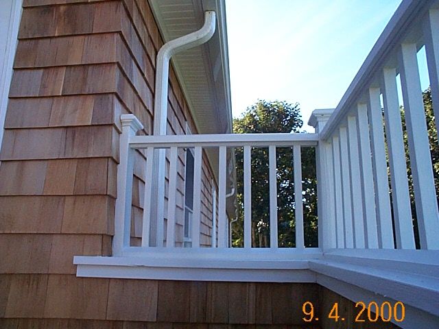

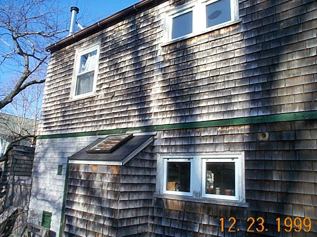

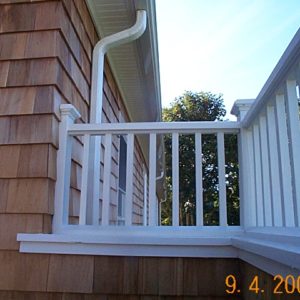

       here's a pic of whites and reds on the same wall.. whites on top.... stained reds on the bottom..
      and then another pic. of a woven corner with reds

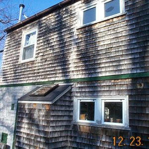

      1. xMikeSmith | Apr 26, 2003 12:30am | #3
        here's a before & after on that same job....Mike Smith   Rhode Island : Design / Build / Repair / Restore
