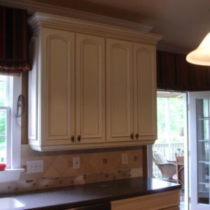

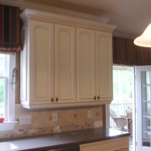

    I don't have any pictures of it at the moment, but a friend of mine is an interior designer who also does cabinet re-finishing.
    I saw a kitchen she did a month or so ago.  they started out as plane white malamin doors..  She tacked something similar to shoe molding on the edges, made "rectangles" out of base cap in the centers to mimic raised panel (like you'd see waynscotting done on walls).  Then she painted them all with whatever kind of paint you need to paint malamine with, and glazed them (makes them look old with brown streaks and highlights)
    I think it was the most dramatic improvmement of before / after of anything I have ever seen.  It went from malamine doors to a high-end kitchen.
    I'll try to get you some pics..

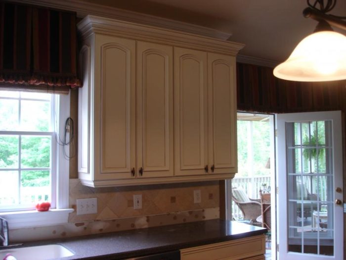

  5. drbgwood | Jun 27, 2008 06:10am | #12
    I did have a picture...
    The picture may be big.  If so I'll try to figure out how to downsize it agian.  If someone could do it for me, thanks.
    these are plain old white flat malamine cabinets... well, used to be.

    2. DougU | Jun 28, 2008 03:24am | #15
      Here's your picture reduced and lightened up a bit.
