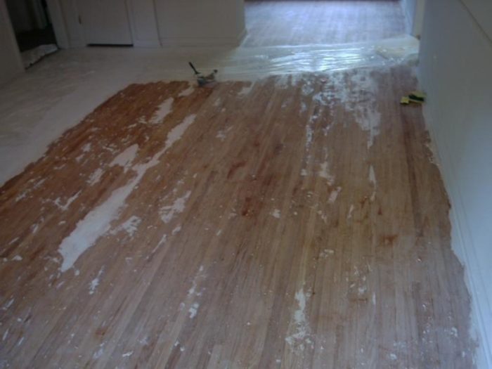

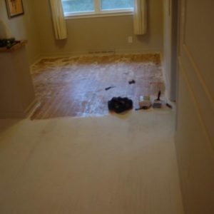

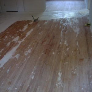

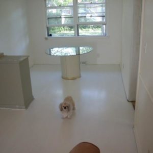

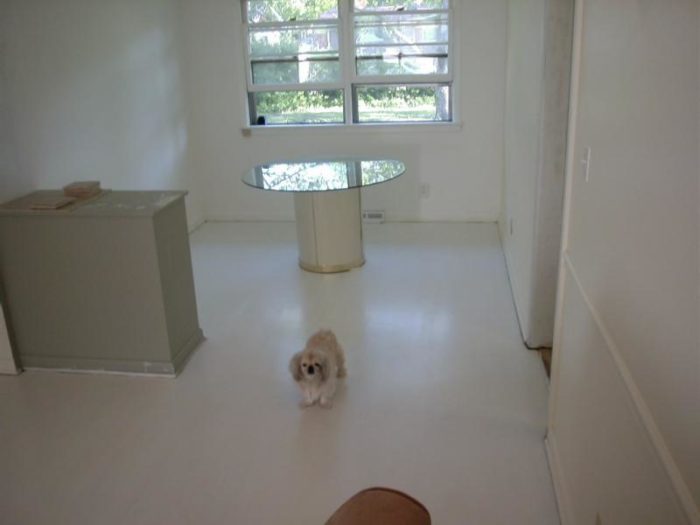

            Larry I used Citris Strip to strip most of the old white oak stain.This stuff is really good AND there is very little chemical smellhttp://www.acehardwaresuperstore.com/citristrip-safer-paint--varnish-stripping-gel-p-464.html?ref=42When you rent the machine you have three choices of sandpaper. The heaviest is 36, then you go to 50, and finally there is 80 gritMy floor was in pretty good shape and I just ran the 50 grit and got it all cleaned up and then hit it with 80 and it looked pretty good and was ready to apply the finish coatI debated whether to carpet the room vs hard wood floors and I went with the hardwood floors.I can refinish the floor cheaper than buying carpet.As far as the rest of the house goes, I have carpet in the bedrooms and hallway.I tempted to take out the carpet and refinish the floors as the entire house has oak floors.BUT wow it's a lot of work. Especially since we're living here and I have to move the furniture.It took me a about 8 days to do the living room - dining room. It's about 13 x 31I had thought about buying beige carpet for $10 at yard at Lowes. About 45 yards total.And I was going to buy their carpet which is 15 ft wide so that I wouldn't have any seams.Anyway, I'll see what happens. during the past week I had calls from 5 realtors wanting to show the house and I had to turn them down becuase of the work on the house.I'm trying to get them back over here this week.Sometimes when they call and you turn them away, it's a turn off, and it's hard to get them to come back.But I've put the new pics in the MLS listing and the house looks a lot better.I would like to sell this house and move into a fixer upper in the riverside area.I looked at a two bed bank repo on Jeannette St one block north of 13th and it's trashed and yet they want 65000 for it I'd need to buy it for quite a bit less. But I really like that area.
          10. mrfixitusa | Aug 11, 2008 03:07pm | #32
            Here's some pictures of stripping the floorWhen you are doing a job like it's a headache keeping animals off the floor when the stripper is being usedI also wanted to mention Something that really worked for me was putting thin plastic over the wet citris stripper as this would allow it to soak inI would keep an eye on it, and at just the right time, I would pull up the plastic and the old finish would stick to the plastic making for easy removal.
          11. alwaysoverbudget | Aug 12, 2008 04:46am | #34
            i can't imgine the mess with stripping. how many days of sanding? whenever i sand a floor i spend lots of time with 36 grit,i  get all the spots out i want ,then all the finer grits go quick and smooth it up. usally go to around 100-120.
            being as you stripped this did you clog up much paper doing it?  thats always my problem + cost of paper. i think the time i used lowes sander i went thru like 50. worth of paper.but the floor looks good.
            if your thinking of riverside i would try and stay south of 13th,north is starting to show some decline.  next  time your in riverside go by 753 [i think?] woodrow,sits on the corner of woodrow and murdock. thats the one i paid 82k for and every day i walk in and shake my head for messing with it. great neighborhood,but the house's are old and are a full time hobby.i don't need a hobby.lol      larryif a man speaks in the forest,and there's not a woman to hear him,is he still wrong?

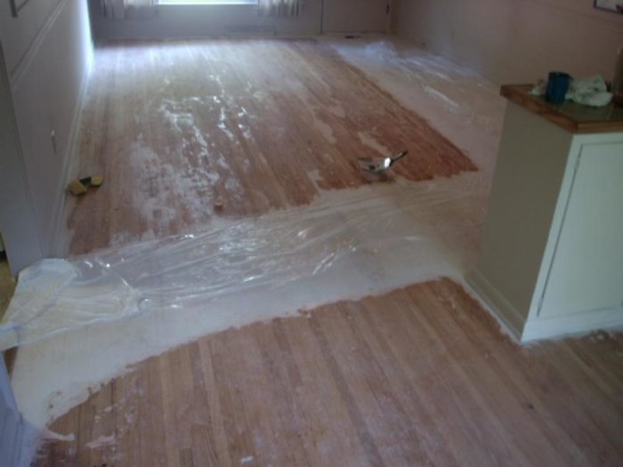

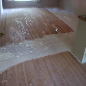

          12. mrfixitusa | Aug 11, 2008 03:09pm | #33
            Here's one with the plastic being used on the floor

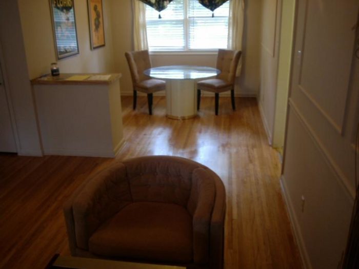

    4. mrfixitusa | Aug 17, 2008 06:06am | #35
      I've had my shellac finish for a week now and I spent some time today on my hands and knees "leveling the shellac finish"There are places where I overlapped when I mopped on the finish and I can see these places.I experimented with denatured alcohol on a soft rag and it works to "polish" the shellac and even it up.BUT what's working really good this evening is to use amonia and water and a soft rag or a scrub pad to polish the shellac and even it outThe amonia dissolves the shellac just as well as the denatured alcohol, AND IT COSTS A LOT LESSWhat's interesting is, if you want to, you can remove ALL of the shellac on the floor just by scrubbing it.I had a couple of places that looked like lumpy jello and if you want to you can just scrub it all off the floor and start over.I've been thinking about floor finishing and my feeling is if you want the floor to have a finish like a nice piece of furniture, I don't think you're going to get a beautiful finish using a LAMBSWOOL MOP type of applicator.It's like trying to use a dripping overloaded mop to apply varnish or polyurethane and it just doesn't seem to work.Not for me anyway.

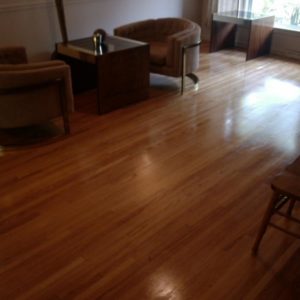

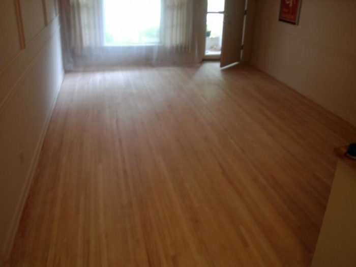

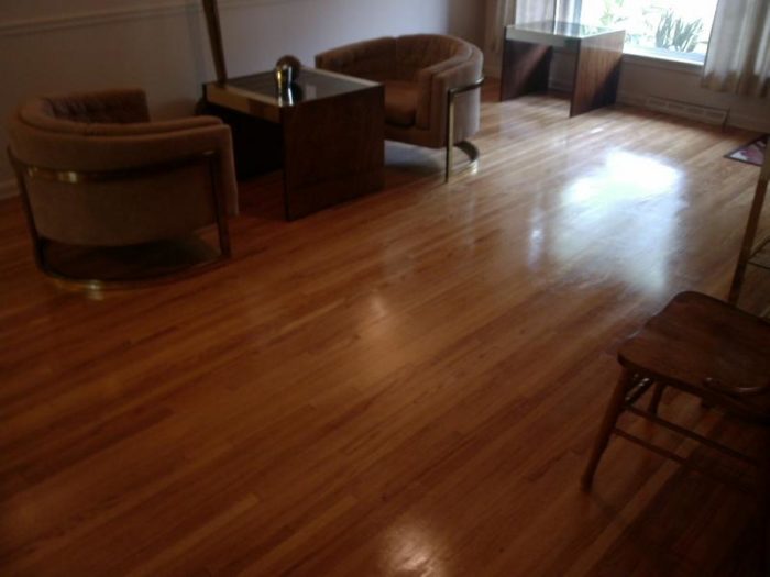

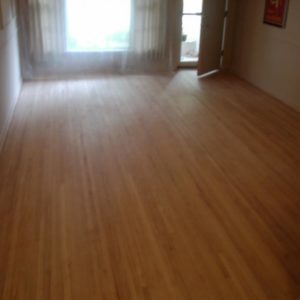

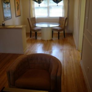

          15. mrfixitusa | Aug 22, 2008 10:00pm | #55
            I stripped the floor and applied minwax natural stain and sealer.Then on Wed I put on a coat of minwax gloss polyurethaneYesterday I put on the second coat of minwax gloss polyurethaneI don't think I need any additional coats of poly.Here is a pic of what I've got right now.What do the professional floor finishers do at this point?Do they go over it with a floor buffer to soften the shine and even things up?
          16. User avater
            Sphere | Aug 22, 2008 10:14pm | #56
            Personally I'd add a coat of satin now, the gloss is harder and the satin is not used for "build coats" , other than that maybe a white pad on a floor buffer. I can't handle the look of gloss , and most others ( with a few exceptions) don't maintain it that  way, due to the immense amount of work to keep it looking "wet".
            The white pad is about as fine as you get , I think it's on par with 4/0 steelwool. Without the oily contamination from Steel wool.

            I've had the high gloss floor for about 4 days now and I really would prefer a satin sheen.The main reason is the high gloss finish SHOWS ALL THE DEFECTS and there are some dimples and scratches in the wood PLUS there are some overlaps in the finishI'm curious to see if the satin sheen will cover up some of these.I have about a quart of gloss poly left overI would like to transform it to satin but don't know how.It DOESN'T affect it if you dilute it with paint thinnerIt's still high glossWhat can I do to it to make it satin?I guess I can mix it with the satin I go buy, but is there anything else?I'm just curious.
          29. User avater
            Sphere | Aug 25, 2008 11:40pm | #69
            NO, don't try to flatten it with anything, it's a propriatary agent they use, some thing like fine silica or talc. It ain't worth screwing up now, just get satin and eat the last qt you have left over, or use it somewhere else.
            You can screen/white pad/ steel wool down the sheen on the gloss, but the can says, for floors, 3 coats. I think you said you have two of gloss, so the last should be satin.Spheramid Enterprises Architectural Woodworks
          30. mrfixitusa | Aug 25, 2008 11:43pm | #70
            ok thanks!appreciate it
          31. mrfixitusa | Sep 01, 2008 04:38pm | #71
            finally got my floor completedI used this 18" lambswool applicator to put two thin coats of satin over the glosshttp://www.instawares.com/lambswool-applicator-block-18.uns4418.0.7.htm?LID=GGLE&ci_src=14110944&ci_sku=UNS4418The difference is night and day between gloss and satinThe floor had a lot of dings and dimples in the wood and the gloss
            made the floor look like a car with hail dents.THE DIMPLES DON'T SHOW WITH THE SATING FINISHIt's incredibleI'll have a picture a little later

          33. mrfixitusa | Sep 02, 2008 04:19am | #73
            Here is the floor with the satin finishI can't tell you how much better it looks from beforeThanks for you help on this one.
          34. alwaysoverbudget | Sep 02, 2008 04:30am | #74
            now i want you to leave the friking floor alone,your going to start seeing the tounges show if you redo 1 more time!
            looks good ,what kinda urethane did you use for the satin.?
            have you thought about starting a floor refinishing bussiness,you have more experence than most out there.
            time to do the bedrooms.................................. larryif a man speaks in the forest,and there's not a woman to hear him,is he still wrong?
          35. mrfixitusa | Sep 02, 2008 04:55am | #75
            Larry, It's minwax oil based satin polyurethaneIt's $26 a gallon at home depotthanks for your tip on using the large lambswool applicatorI bought one at sherwin williams? at 21st and tyler for $20I used it for two coats and you don't want to have to buy another applicator for each coatYou can re-use them if you let them soak in paint thinnerthe satin hides the dings and dimples.something I noticed is you don't ever want to have a "dry edge" with your applicator.I kept having a dry edge when I was mopping on the poly straight from the canIt's thick and sticky. It doesn't flow very well.On my last coat I thinned it a little bit so that it would flow and I didn't have any dry edges Another observation I had was bubbles would form when I mopped the poly on the floor.I would smooth out the bubbles by going over it slowly.Interestingly most of the times the bubbles would evaporate but there are a few spots where there are some dried bubbles.Most people won't be able to see it though.Another mistake I made was putting on a coat in the evening.Yesterday I applied a coat at 6 PM and it was dry enough to walk on it by 9 PM but I had to smell the odors until midnite or 1 AM it finally cleared outI had fans running and the windows open but even so, the smell was pretty bad.Time to move onto the next project.I think I wasted the last month messing around with these floors oh well, lolEdited 9/1/2008 9:56 pm by mrfixitusa

      2. frenchy | Aug 17, 2008 09:38pm | #42
        mrfixitusa.
          You see you got in the way of letting shellac do it's own thing.
           Those ridges you built up are the direct cause of going too slow with too thick of a finish.. the bumpy spots where from going back over.    IF you'd over thinned as I keep preaching and just flood it on quickly that lambs wool applicator would work just fine.
          To be honest I've never tried ammonia as a leveling agent.  I'm not sure Some wouldn't remain and leave that spot softer and weaker than pure shellac with denatured alcohol.. (I don't know so please correct me if I'm wrong)
        I suspect you are a carefull painter who tries to be neat, next time let a teenager do it and tell him to do it as fast as he can  <grin>
        1. mrfixitusa | Aug 17, 2008 09:43pm | #43
          I think you're rightI'm going to try it again and this time thin it like you've described.What's frustrating is some people could probably apply it FULL STRENGTH and without diluting it and they would make it look great.I'm tempted to brush it on full strength straight out of the can just to see what would happenI would just put on one coat and leave it at that. I like the looks of a thin coat of shellacI would go buy an expensive 3 or 4 inch high quality brush and just see what happens

        I've got some pictures of before and afterI started my project with a "white oak" stained floor that I botches up and it looked terrible.So I stripped the white oak stain, sanded the floor, apply min wax natural stain, and top coat with Shellac
      3. mrfixitusa | Aug 10, 2008 10:40pm | #20
        Here are the after pictures.
        1. Danno | Aug 10, 2008 11:03pm | #22
          Looks good! I love wood floors--unfortunately, wife hates them. We have carpet everywhere but in one bathroom. Carpet is quiet, but if wife knew all the crud that was hiding in the carpets...!
