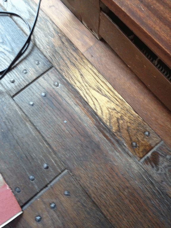

 Hello – We recently purchased a house built in 1975. The living room floor is a “Rustic Oak” floor. The boards are varying width and are slightly beveled on all four edges. Each one is top nailed at the butt joints with two or three blacksmith nails (for lack of a better name, the heads have an uneven hammered look). Some of the top nails are set below the surface but others bump up slightly.
The floor looks like it has been stained but likely never refinished. It is worn in some areas and lighter in areas where there had once been area rugs. Because of the bevels, the edges are dark.
My question is – how do I refinish this floor? My first thought was to sand and stain to even the color out and then poly. But I am wondering about the nails ripping up the sander.
FWIW, I had been hoping these were the “decorative tack” type of top nails that could be removed and replaced but they really are 2.5in cut nails.

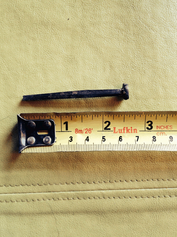

      I have not pulled a board up but it does not feel like an engineered floor - I'm told it was original so it's going on 40 years old. Were they making engineered floors back then?
      Coutersinking is a good idea, my worry is that since they are cut nails, I end up loosening more then I sink. It's definitly worth a try on the more pronounced ones though.

    1. kevininmaine | Feb 05, 2014 12:20am | #18
      Top Nailed floor
      Pulling the nails is out of the question - It would destroy the floor in my opinion. I think if I had to go the route, I would replace the floor completly.
      My plan is to try and set the highest nails and then sand with a random orbit sander and hit any spots that get missed with a palm sander. For a finish; stain to even out the color and the 3 coats of poly.

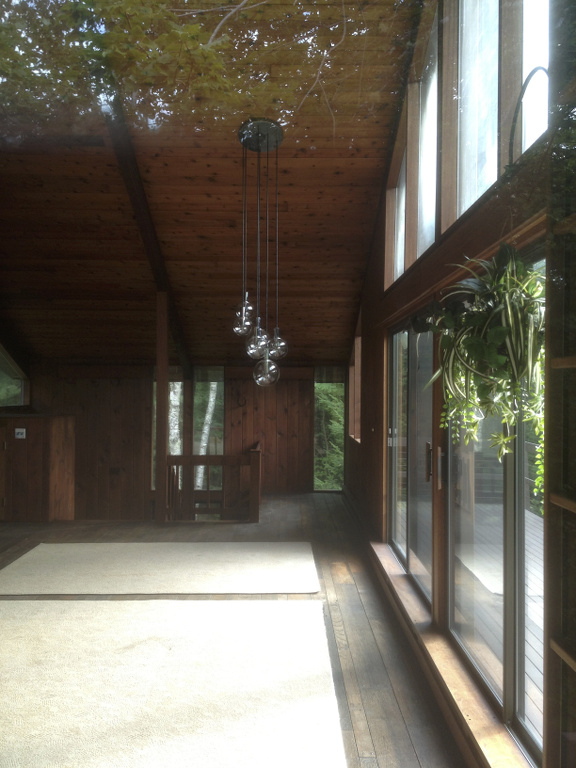

      Here is a bigger picture of the room - we are in the process of replacing the knotty pine on the walls with sheetrock. Again, to help show the trim better.
