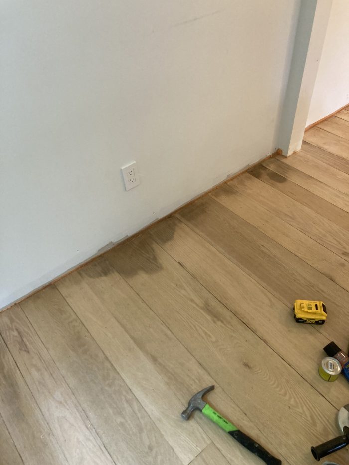

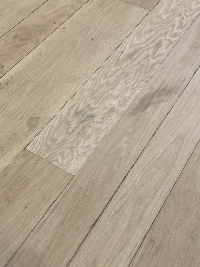

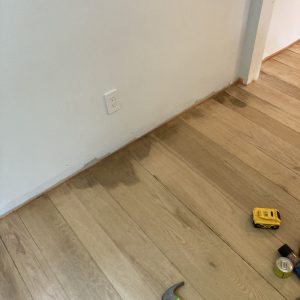

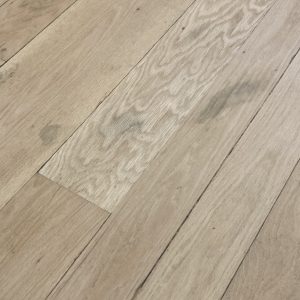

Hello,
I am hoping someone has experience to share on rehabbing  80-yr-old red oak floors. I have drum sanded them to remove the finish, but many of the boards have unsightly and stubborn stains (see pics).  Some of them appear to be from long-ago water damage, and others from who knows what. They are not easily sanded away and seem to penetrate pretty far below the surface.
As an experiment I dug into one such area.  I had to go at it with a 36 grit disk on an angle grinder to get to “clean” wood — almost 1/4” down in some spots. It seems impractical/unwise to do this everywhere.
Are there any magic stain-lifting treatments?  Or, is it acceptable to grind down 1/4” (the existing boards are a full 3/4”—maybe never sanded in all those years).  And if so, should I bring back the drum sander for the most even job?

  1. designbing | Jul 26, 2024 06:07pm | #1
    Have you tried oxalic acid? It will bleach out the dark spots. You have to play with it. And frankly some stains just won't come out
    1. carpenter | Jul 26, 2024 07:44pm | #2
      Thank you for the suggestion! I ordered some and will try it.
    mmandcoroofing | Jul 29, 2024 10:48am | #3
    Oxalic acid is a good idea, but remember to test an area first else you could end up with very white patches inside of the dark ones.
    Good luck!
