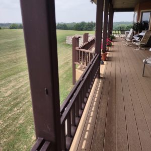

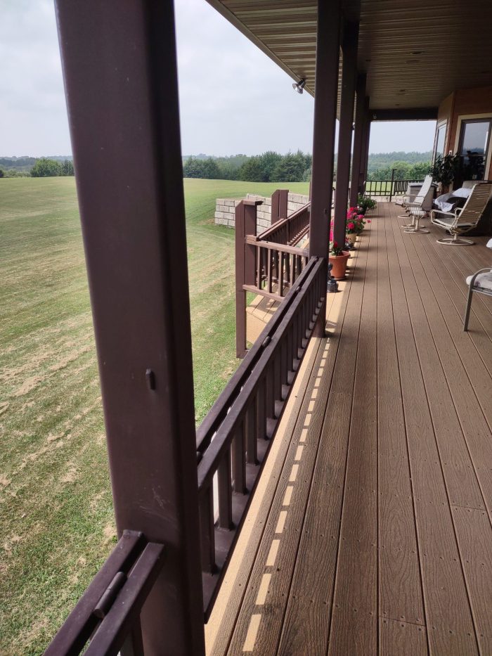

  15. Dan_N | Jul 03, 2024 02:49pm | #24
    Okay - that post from 2006 has still not been solved. Here we are in 2024 and Im researching deck railing ideas to make the most of my lake view. Many of the ideas in this brain storm are neat - thank you - and now I shall share a video I found of a van life roof deck folding railing system: https://www.youtube.com/watch?v=JqCClKTsdiU
    I have also seen my Uncle-in-Law deck rail out in Iowa. His was all steel but its a great idea. Essentially at the 24" horizonal he put in a hinge and the deck rail swings down (inward) at the hinge. He put some stops and locks on the uprights.
    Now my idea is to take three things in one. I am planning a 42" high "cocktail" railing.
    I want to make my deck rail from "hog wire" or "chicken wire" with coated or 16 gauge wire. Next I will split my railing to drop similarly to what Uncle Richard did. If that is not enough I want to build in sections that are benches facing inward that can convert to picnic tables facing outward. Amazon has brackets that accomplish this here: https://a.co/d/0eACes1p. So in my corners Ill have the built in benches and the rest of the deck length Ill have the drop down.
