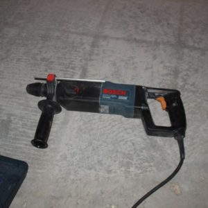

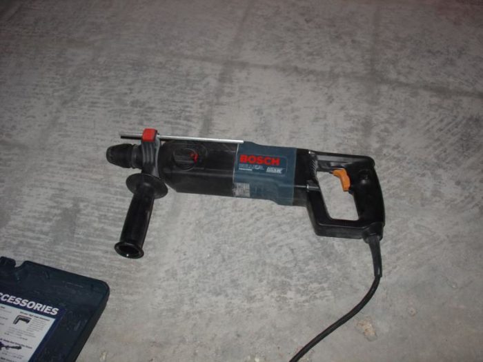

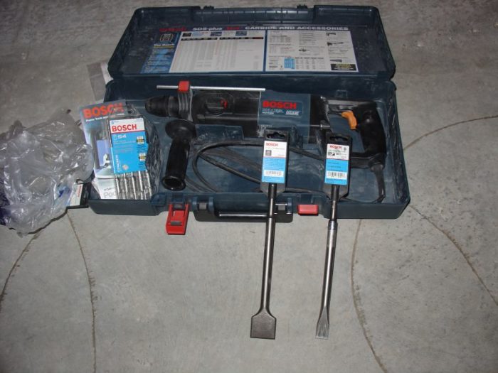

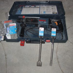

me: I'm always up for using my Bosch SDS plus Hammer drill and viper bit for this kinda work!!! <g> There's probably a smarter way?DUM SPIRO SPERO: "While I breathe I hope"

Bosch Bulldog with a viper chisel...

You've got it right! A rotary hammer is the key and once you get the hang of it, they come off real nice.
I just used my Milwaukee rotary hammer to take up a bunch of quarry tile for a repair.
I should add that it is important to use a good rotarty hammer like Bosch, Milwaukee or Hilti.... cheapies just don't seem to work as well.
