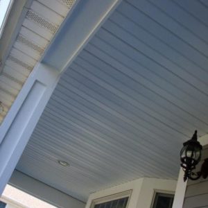

We have a small job that has to get knocked out before the next big project ramps up next week and I want to avoid any surprises as none of us have done this before.  It certainly seems innocent enough, but I’ve been bitten on the a
before.
Has anyone replaced the vinyl exterior porch ceiling panels with Azek 1/2″ x 6 beadboard before? Specs: the house is in NY, it is 7 yrs. old and the ceiling length is 35′ with an average width of 8′.&
#160; The vinyl is sitting in what looks alot like a J bead channel on the outer perimeter and doesn’t appear to have many/any? intermediate fasteners.  Any insight is appreciated.

    just my two cents, but from the photos I'd say why bother???
    1. Taylorsdad | Apr 24, 2005 12:53pm | #3
      I am in full agreement with that thought.  But I'm the contractor, not the client and thats what they want - well, I doubt the husband actually cares.  Its a neighborhood of million dollar homes and everyone is hell bent on being at the top-end of best homes in the neighborhood (good for us!).  Honestly though, it looks much worse than the photo depicts.

          The garbage thats in there now is flimsy and sagging - again, it isn't noticable in the photo.  The purpose of this thread was to find out if anyone has done this before and to find out the general opinion of the performance of this product.  If it outperforms wood, then they made the right choice, if it doesn't I'm going to recommend against it.

            the Azek beadboard is a decent product...I second what other posts have said about it being floppy, & about not knowing what's under the existing vinyl....My biggest concern if I were in your shoes would be that, if I'm seeing your photo correctly, all the trim on the porch is currently wrapped in metal or vinyl...I'd be focusing on how to get the new ceiling into the small gaps at the head of the existing trim(s).....
