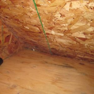

Also, as one of the legs of the radiator pipe upstairs is in a crawl space but above an unheated patio there has been major condensation and freezing (when we get cold temperatures like -20 C) on the OSB in that crawl space. The space is about 6 feet deep by 9 feet long. It has the one copper pipe with glycol coming through it. We have pipe insulation around the copper pipe and a 3 sides wooden box that just sits like an upsides down “U” above the pipe to protect it from being damaged. And to make it less heated. There is a light and lightswitch. The space is insulated but not ventilated. It is in our son’s room but used as storage/infrequently.

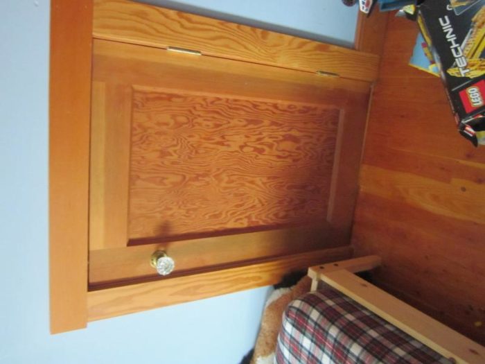

Do we rerun the 3 ft of  line that is in the sort of unheated space and put it inside the adjacent heated room/ son’s bedroom and make that storage space no longer accessible? Do we remove the insulation and check for mold/leaks/something else and replace it or add some sort of air exchange? Should we remove the old fir panel door that was fit to the space and make it an insulated wall like the rest of the wall on that side? Would you totally add insulation to the space or take it away?

    A handy guy and i tuct taped the poly that was under the batts between behind the OSB and exterior roof and sprayed foam in the cracks between the wood joints. Seems like a mickey mouse kinda fix but it should make for a better air lock. There was also a large empty/air space between the batts and roof.

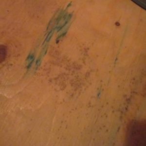

    i think the next step is to get rid of the flooring that appears to be moldy/black/spotty. the OSB on the ceiling was actually visually fine  (when removed for crawling into the space) As total removal of the floor is difficult, my handy guy suggested an anti mold paint.
    Does a modern material such as antimold paint really stop/solve a moldy wood issue or just cover it slowing it down till a later date?

    working on beefing up this space
    A handy guy and I got the tuck tape out and taped the vapour barrier in the space above the OSB and under the batts.I also sprayed 1 can of that spray foam between any wood joints. Seemed kinda mickey mouse. The OSB looks ok-like no mold or warping. The wood on the floor doesn't look as good though. It is kindof black and spotted/moldy as per picture. I have been told it would be really hard to take out the floor wood with the mini door and would more likely cause new air leaks so to just paint it. I am not convinced.
    So wondering how to tell if there is enough insulation in the space as is. How/where do I get an air leak test or insulation test done?
    Then I think we need to kill the possible mold on the wood and paint with some anti mold paint, increase the length of copper pipe and fins in the room (have some run along the north wcall and towards that bad corner) and lastly maybe put a hole in the north wall and run a small 50cfm inline fan that runs often.

    The condensation in the crawl could be due to a number of factors, but it sure makes one wonder if there isn't a leak in the heating loop near there.
