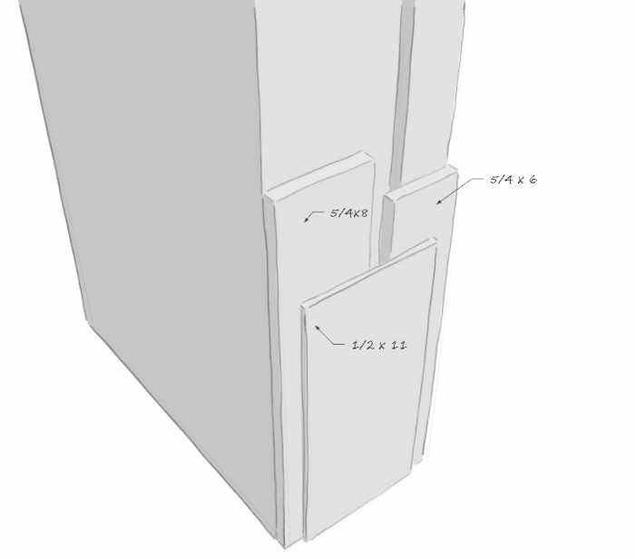

I'm not sure I have a complete understanding of the doors but I'd at least consider doing something like the following. You'd need to mill the 1/2 x 12 for the stop and that could be a problem without access to a planer.
Consider using 1.5" x 16" LVL for your jambs with the appropriate paint to make it weather resistant.
