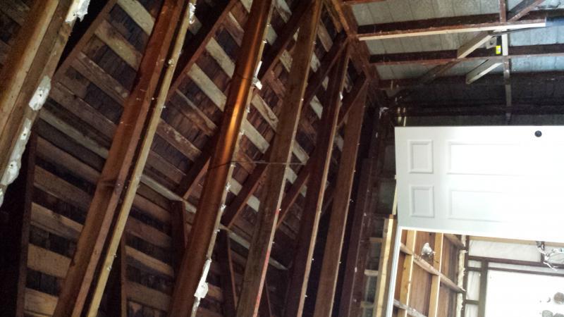

Im in the process of remodelling my garage and im looking at the roof structure now.
I dont know all the tech terms, but i basically have a 20ft long garage, with about 10 beams(2×4) going from the top of the wall and up into the center at about a 35 degree or more angle. And 2x6s going across the ceiling. I want to replace the 2×6 and put in some nice 4×6 redwood beams i got.
I want to take out the 2×6 and put in 4×6 on every other beam to give more open ceiling space. I also want to add blocks in between each 2×4 to sturdy out the roof.
My question is regarding the 4x6s. I obviously dont want my of to collapse so im wondering if putting the 4×6 on every other beam would be enough to support the celing also considering i will put two rows of blocking in on each roof side.
Im not sure im explaining this right. In short will my roof hold with half the ammount of beams and 4 total rows of blocking.
Ill try to add pictures once i get back home. Any and all input welcome!

        As to do-ability, the horizontal joists are there to resist the outward pressure of the diagonal rafters.  Take away every other one (without adding some sort of substantial beam at the ridge or along each side) and half the rafters are left without support.  It probably wouldn't fall down, but it would start looking strange in 5-10 years.

    If I'm interpreting your question correctly, what you want to do is replace ceiling joists with rafter ties. It looks like you're at 24" oc, so you'd have a 4x6 rafter tie at 48" oc instead of 2x6 ceiling joists @ 24" oc. I don't see anything wrong with this if you make sure the connections are adequate. Use straps joist to rafter and to top plate. I'd think about beefing up the rafters to 1. increase the strength and 2. allow you to insulate.

      I put 2x4 diagonally from the top of the rafters that wont have joists to the bottom of the rafters that will have the rafter ties to displace some of the load. In additio   beefing up the rafters and block in between.
      This is in california close to the bay so no snow here.
      The structure was built in the 50s and we have been replacing 2x4 that had termite damage.
      Also using braces and straps on the ties. In addition i will run a 4x4 beam the length of the roof that will sit right up against the rafters where they meet in center. To add suppory but also to utilize redwood beams to make it all look pretty. The rafters will be hidden with sheetrock and the rafterties and top beam (4x4) wil be made visible to give the space a nice touch.
