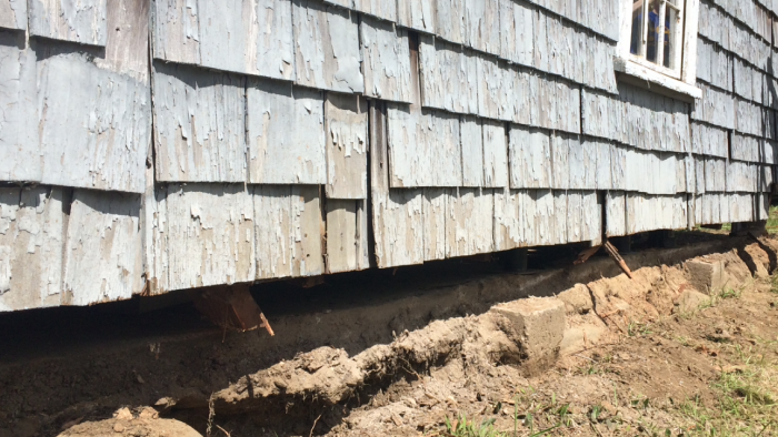

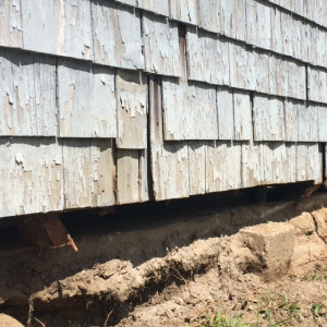

We moved into our 1927 bungalow in December and have been slowly tackling small projects. Last weekend I wanted to make some repairs to the detached garage, but it turns out the damage was more extensive than anticipated. At least 1/3 of the sill on our ~90 year old  detached garage had been eaten by carpenter ants. The middle of one side was completely gone and the studs were sitting on dirt. The original sill was two 2x4s simply rested on piers that were spaced every ~4.5ft on center. Garage is 18×9. I think the original garage just had a dirt floor and these piers. Later a concrete slab was poured that sits 2 inches higher than the piers, but also inset from the walls by 1-1.5 inches.

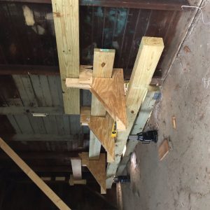

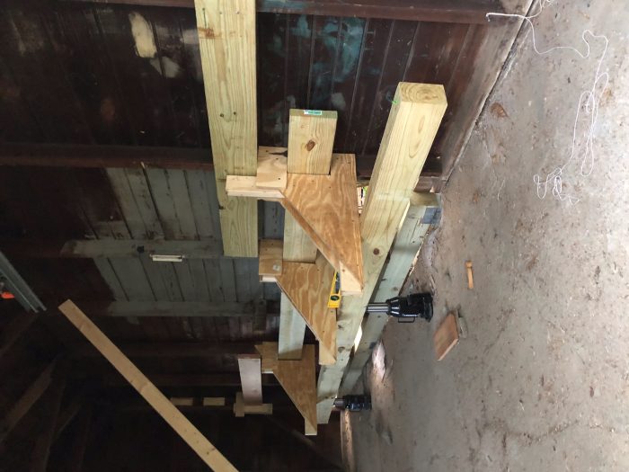

I raised the worst side first in sections, raising the middle section, then the two ends by adding additional ledger boards as I went. I couldn’t do it all at once since the center of the wall was 6 inches lower than the ends. I added diagonal bracing from walls to ceiling joists, and I also braced against the top plate on the outside against the way it was racking.

Pictured is the jack system I used (found on fhb), where you can see the 4×6 on the bracket. I still have to do the other end. Other picture is the bad side where the sill was actually nonexistent. You can see the piers in that one.
