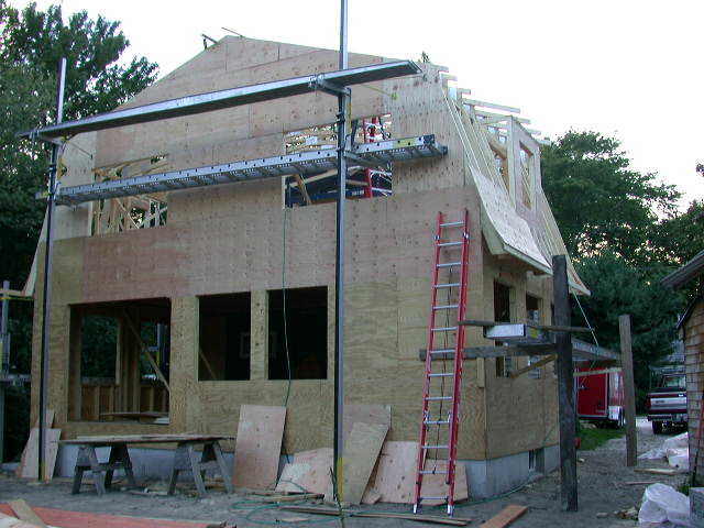

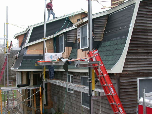

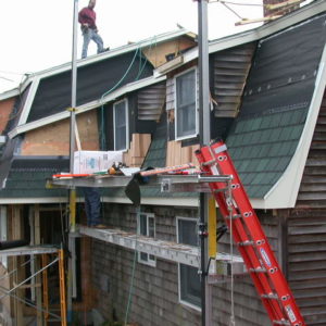

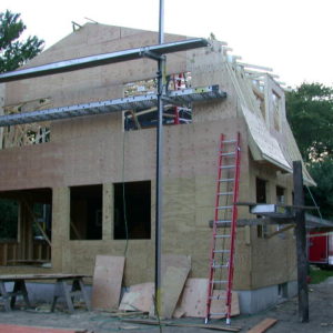

    we prefer Alum-a-pole.. fast to set up, like working off a sidewalk.... very flexible attachment...spans up to 24'

      i like the set-up, though the photos aren't entirely clear on the fastening system used to support the units to the structure.  they appear to be tie straps instead of rigid ties.  i'm sure the product catalogue will clarify things.
      this system would be more appropriate for in-place or contiguous work.  we are going to be replacing individual sheets in scattered locations.  we are budgeted for 1 hour for two men to remove and replace one sheet on the second story.
      scissor and boom lifts are not in the budget.
      alternatives?

        fonz... i got started easy.. a roofer was going bankrupt , so i got the first (4) 24' poles, jacks < & braces for $1000..
         typically a 24' two pole set up will run about $2000.. incl. (2) 24' poles, two jacks, two folding braces, two workbench supports, a 14" x 24' pic &  a 20" x 24' pic....
        if you figure on them paying for themselves over 2000 hours , that's a buck an hour.. pretty good productivity for a buck an hourMike Smith Rhode Island : Design / Build / Repair / Restore
