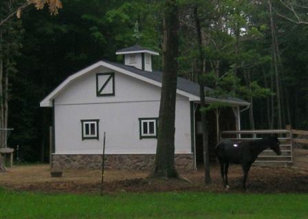

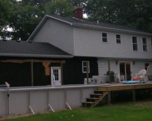

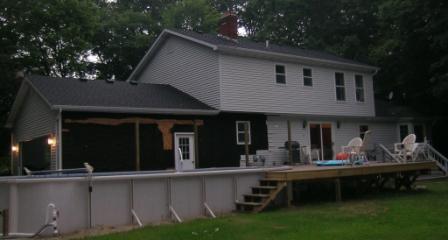

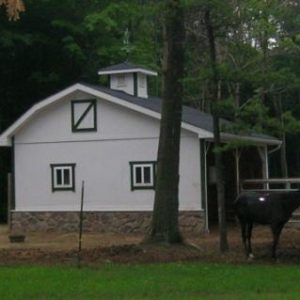

          I also attached some shots of what I have gotten done so far...added pool and remodeled deck to meet it.  Keeping in mind that next spring I'll remove the rest of the old deck and begin adding a 4 season screened porch centered on the doorwall.  The other pic is the barn I built 3 years ago and am proud to show off in front of a group of craftsmen that I can do it ...but probably couldn't get paid for it :-o
