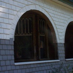

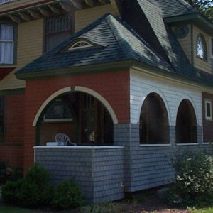

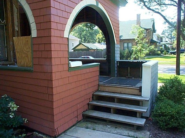

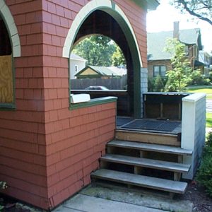

I’m a DIYer restoring my old porch, see attached photos. I have finished the cedar shingle siding on the exterior of the porch and I still have the following items to address:
(1) Interior Walls on the Porch – County Lead N azis made me remove all the original T&G boards and I need to decide what to replace them with.  My criteria is that it has to last 50+ years and not be as labor intensive as cutting all those individual shingles around the arches.  Any suggestions would be appreciated. Ceiling is getting T&G beadboard.
(2) T&G porch floor is rotted and needs replacing. I was thinking of putting 3″ Ipe Tongue and groove down, since the porch is covered, but my worry is the little landing that is uncovered. It gets full sun, rain, and snow. Not sure T&G would last long. Would it look odd to have t&g on porch and spaced boards on the landing area? Again, I’m looking for suggestions.  Since this is an original porch I’m trying to preserve the historic character. At the same time I don’t want to have to redo the flooring in 5 or 7 years. (existing porch appears to have the correct slope away from the house)
(3) Arch Boards (76″ radius) have severly chipped edges and need to be replaced or patched. Might be easier to replace.  I know I can get PVC boards that will bend to that radius. Does the PVC expand and contract too much for this application (Chicago area)? Would soaked cedar boards be able to be bent to that radius? Any other options?
This is a big project for me and I want to do it right so I don’t have to redo for many, many years. Thanks for your help.

        First, I assumed that the interior side of the porch was sheathed -- from one of the photos, that does not seem to be the case.
        Second, I assumed that you would be installing a radiused casing..... is that the plan?
        Also, I overlooked something regarding the way the trim interacts with the siding.  I've been assuming that radiused casings would be nailed directly to the sheathing.  If that were the case, you'd need to scribe your siding so it butts into the casings.
        Beadboard, on the other hand, would not require this.  If you built the arched jambs deep enough, you could treat the beadboard like a simple wall surface, and run it merely approximately up to the arched jambs.  The radiused casings could then be installed OVER the rough ends of the bead board.
        This method should NOT be done with beveled siding --- the triangular voids left as a result of "overlaid" trim look terrible and are a haven for bugs and debris.
        One last observation: beadboard wouldn't require sheathing beneath it, either.  You could just blind nail it directly to the studs.  Since there are now some obvious benefits to using beadboard, perhaps that's why it was used in the first place.
