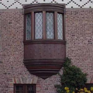

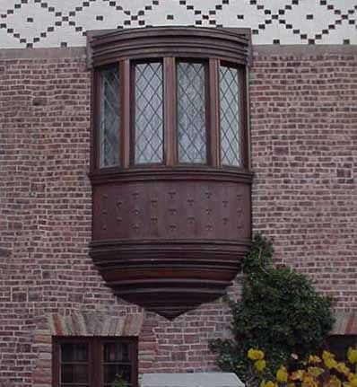

    Just so you'll know I know what I'm talking about here's some of my work:

      1. TerrySmiley | Apr 14, 2002 05:40pm | #4
        Yes Grant I built a maple form to match the profile of each molding.  I cut copper strips oversized, annealled them with a cutting torch and hammered them onto the form. It took me 6 weeks of hammering.
