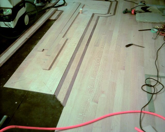

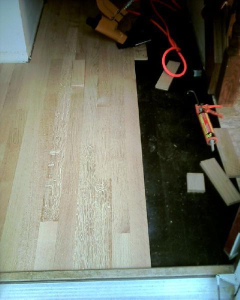

Just started this rift and quartersawn white oak floor today. It will contain a nice border of w.o. and walnut around the kitchen island.

Fitting the border:

Nice work. I love 1/4 sawn white oak. The finished pictures should be real interesting.

The octogon end, which outines a granite counter top above, was filled using an 'angled plane' technique. Basically just mitered corners at 45*. As you walk around the room the field changes, almost like an optical illusion.....but you already knew that..haha.
Notice the Festool dust containment unit. I have been using their big plunge saw with guide rail for this kind of work....real time saver...and very accurate.Ditch

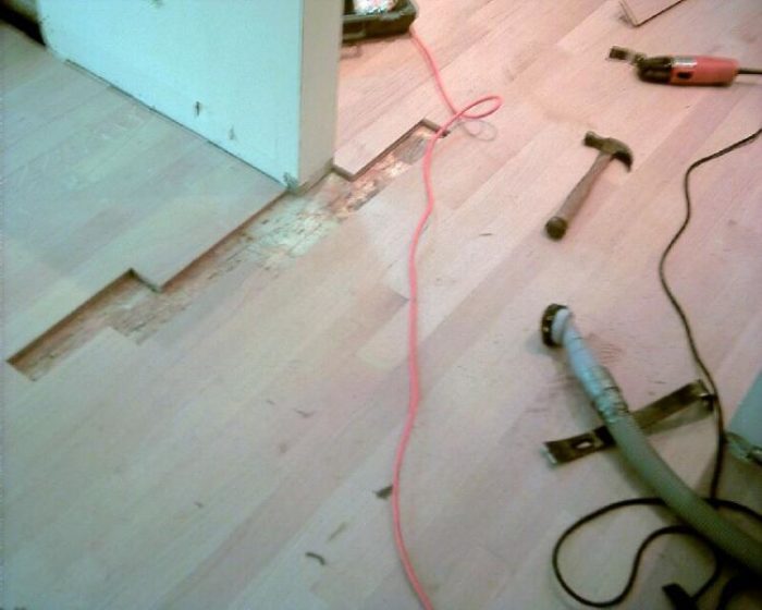

BTW......The kitchen designer decided to shorten a knee wall by 6" after the floor was installed. I had to make repairs to a perfectly good floor install.....and then he refused to pay for the repair time....really pi$$ed me off.Ditch

Very nice looking work. How you keeping all those miters tight?
T and G....splines....biscuits? Just curoius...looks like alot of work no matter how ya do it.
Hey Jeff,
It goes quick. The floor is about 95% locked. I use a top bearing slot bit and splines to lock the miters. Ditch
