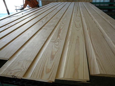

We have a carriage house we plan on converting to guest quarters. The structure was build around 1910 with 2×4 studs and clapboard lap siding like in the attached image. This siding is referred to as cove siding, dutch siding, drop siding, etc.
The structure is rather small so we are strongly leaning towards 2″ ridgid foam on the exterior plus insulation in the stud bays instead of firing out the interior and loosing space.
The question is can we add the foam over the exising siding since it provides a flat mounting surface – exept for the coves? The alternative is to tear all this off, then cover it right back up with sheathing. The siding is sound and straight.

You can definitely add foam on the outside. The difficulty is with how you're going to fasten the new siding afterwards -- there are several different schemes.
Knowing where you are and what weather conditions are like would inform further comments.

A couple things spring to mind.
Lots of times out here in WA those old outbuildings were built right on the ground, or if there was a slab, the wood siding went right down to the ground.
If that's the case in your building I'd strip the bottom 12" or so of siding off and replace it with pressure treated plywood. Better yet would be to pour a short stem wall or put a row of CMU under those walls, but that requires far more work. Main thing is to get at least 8" seperation between ground and any rotable (?) building materials. If you're going to convert this to living space, go ahead and commit to rebuilding it for 200 year life.
But as for covering that old siding, as long as it's in good shape - we do it all the time. We generally renail it off before covering it. Galvanized nails weren't as common back in the day and lots of times those old buildings' nail are loose or have backed out some. Check your corners for plumb, brace as needed then face nail it two nails/board/stud - you'll get plenty of shear value.
