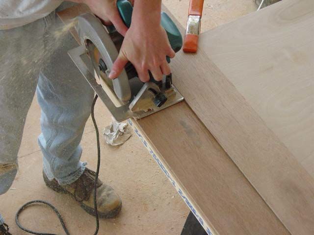

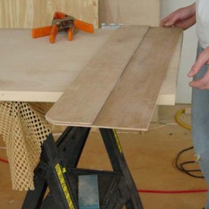

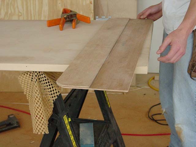

  3. CAGIV | Mar 13, 2003 07:44am | #3
    Heres what I would do lacking a table saw.  Don't let HD or Lowes do it, they will screw it up.
    Figure out the width you want for the book cases
    Pick up a piece of 3/4 MDF
    Figure out the distance between the edge of the tooth that kicks out towards the edge of the saw and edge of the base of the saw.
    Rip a piece of MDF off one side about 2 inch wide.
    Then Rip another piece off the other factory edge wide enough to accommodate the width of the shelf + the two inches of the first piece
    Put it together like the picture.
    You can use it as a carriage for consistent rips if you clamp it to the edge of the Birch.
    Make SURE the factory edge is facing out so the saw rides against one and board rides against one.
    Set it up on saw horses with a sacrafial 2x to make sure the piece your cutting doesn't hit the ground when you cut it off. and adjust the saw depth to about 1 1/4" and have it.
    Use a good sharp thin kerf blade and flip the plywood finish side down to avoid tear out.
    Make sense?
    At least that's what I do with out a table saw.
    View ImageGo Jayhawks

    1. CAGIV | Mar 13, 2003 09:00am | #5
      Davo,
       Around here a 3/4 MDF is going to cost about 10 bucks more then 1/4 in luan.
      IMHO 1/4 inch material could be a bad choice for two reasons.
      1. Its to flexible, I like my guides nice and rigid 2. Depending on the saw, many have a radius on the shoe which the saw could "jump" and ruin the piece.
      The reasons I didnt suggest the same as Uncle Dunc is because he wants very consistant rips, and I also took it that he did not have much luck ripping in the past
       Its possible the way you and uncle dunc suggested but the set up time of laying each piece out and making it perfectly square at the perfect width for a multitude of the same cut adds up
      The way I suggested will you give a very consistant width and is self squaring to the ply.   I've tried both ways, a shooting board is great for one or two off cuts, But they take much longer to square up and its harder to ensure you get the exact same width every time. opposed the other way.

        1. CAGIV | Mar 13, 2003 12:24pm | #8
          Uncle Dunc,
            You only need about 6 different ones :)  if you just screw the two pieces together you can un-screw it later and move the "fence"  And like I said its a lot easier to ensure square and equal cuts repeatedly
            It certainly doesn't replace a table saw, but it beats the heck out of trying to rip down 4x8 sheets on a little job site saw when you don't have a stand, out feed roller and an extra set of hands...
          Edited 3/13/2003 5:41:48 AM ET by CAG
