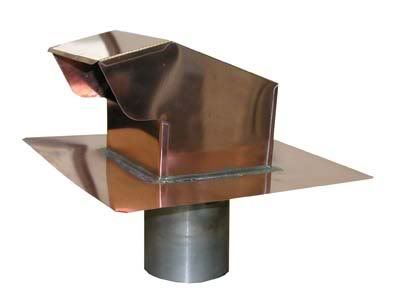

I have to vent a dryer straight up through a low slope rowhouse roof, and I’m not finding any really good vent solutions for this application, so I’m hoping someone can point me in the right direction with this…. First, there are roof caps like the Fantech RC:
I worry that with a low slope roof, this type of vent would be vulnerable water intrusion with the occasional snow or heavy rain, since it would be near horizontal when mounted. Also, from what I understand, venting a dryer through the roof isn’t usually a good idea because you’ll get moisture condensing on the vent cap and running back down into the house. Being this is simply a sheet metal cap, I can definitely imagine this happening…

    I had the same problem with roof vent for bath fan, that is, heavy rain reflecting off the  roof and coming into the duct.  If you installed the cover (your picture) directly on the roof, you will have water problem.  How about building a box 2' high? The cover can go on top of box and can be flashed using the cover flashing.  The box will have to be flashed to the roof with appropriate material.  If you are not sure, check this site-Eternabond.com.  I had success with this flashing tape and I can recommend this with confidence.

      So you're saying to mount it vertically on a box I would built out of my roof? or would simply increasing it's angle be enough to keep the damper from opening with wind driven rain? I'm thinking maybe a wedge shaped curb.Thanks,

        The vent cap could be on the top and you could add sheetmetal around and over the vent door so the wind driven or splatter would not go back into the vent.  This is what I did with mine.  Or the vent could come out on the side of the box as well, I think this might be better protection from the wind.  The roof of the box could be removable for maintenance.  Hope this helps.

        I would stick with a more typical roof jack with damper, but get a decent one, not one carried by big box stores. We have used ones from Grainger, who you can order from online. They cost more but they have all different sizes and are heavier built than others I've seen. There is less for any lint to catch on with these.

          I was actually looking at Grainger, especially since they just opened up a branch 3 blocks from my house ;) But it looks like they only carry Broan roof jacks in the 4" size, and unless they're complete different from the Broan roof vent at the Homey D, they're cheaply made.So if I want a vent with a damper I'll go with something like the Broan roof vent and put it on an angled curb to help prevent water intrusion. I'll have to rip the bird screen off, but at least if I do have problem, it's easily accessible for cleaning. If I do a simple U vent, Pontyl, is there a specific type of pipe for this? The IRC simply says "metal", but if I'm running out the roof, I assume there is vent pipe rated for exposure...Z
