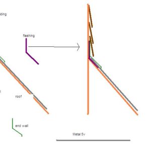

Would one run flashing (purple) first behind end-wall flashing (in green) when running a metal roof?
It seems odd, essentially your nailing one piece of flasing to another.
Here’s a rudimentary pic:
WWPD
WWPD
Normally, when I do this detail, there's no seperate piece of flashing. The roof pan gets folded up the wall. In any case, if you can't flash well enough that one flashing won't keep out the water, then two aren't gonna do it either.

The green end wall flashing is all I would do, but it does get backed up with tarpaper or I&W
