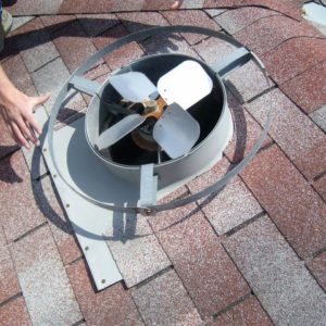

I was called to a house today to find a roof leak.
Last couple of roof leaks have been the rubber boot on vent pipe was bad or bathroom fan piping laying on the insulation was finally shot.
Anyway there was brown spots on the ceiling of the hallway in the center of the house.
I trace leaks quite a bit but this one has me stumped. I’ll post a picture so that you guys can help me out.
Any ideas where the leak came from? Thanks for the help.
Rich
  1. davidmeiland | May 05, 2009 06:29am | #1
    I suppose if the fan is spinning fast enough it'll keep the water out.
  2. alwaysoverbudget | May 05, 2009 06:35am | #2
    i think those nails on the bottom of flashing are the problem. :]
    if it was me i would ct a 5gal bucket of tar,fix the nails use remainder on the fan so it don't rust anymore
    YOU ONLY NEED TWO TOOLS IN LIFE - WD-40 AND DUCT TAPE. IF IT DOESN'T
    MOVE AND SHOULD, USE THE WD-40. IF IT SHOULDN'T MOVE AND DOES, USE THE
    DUCT TAPE.

  7. cic317 | May 05, 2009 04:11pm | #8
    First guess would be the nail on lower end of flashing are allowing water to enter because the shingle crotch are very close to side flashing ends, on a heavy rain I would bet water is entering the crotch & working under the side flashing until it rolls down & enters thru the nail penetration, I would lift the side shingles Add silicone to the entire side flashing & relay shingles, or add a piece of flashing under the crotch cut outs instead. Don't forget to add some silicone to the exposed nails & low end.

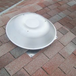

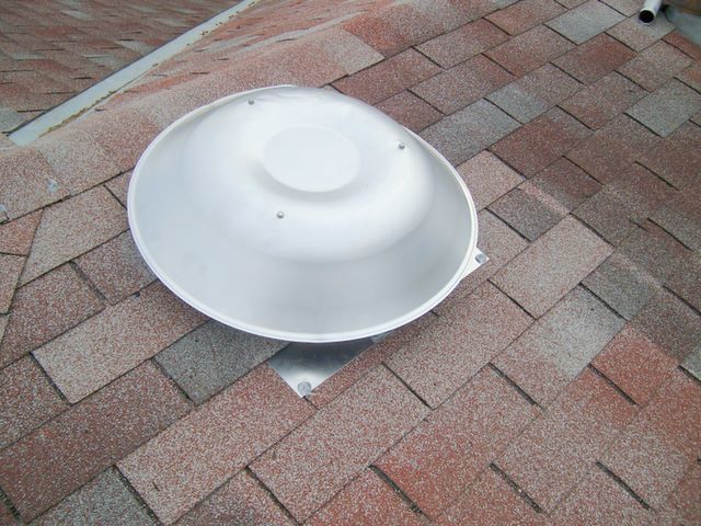

        like so...
        View ImageRoof-Mounted Power Attic VentThe All Season™ model fights heat and humidity with a combination automatic thermostat/humidistat.
        View ImageSolar Powered Roof-Mounted Attic VentAn environmentally friendly, energy saving alternative to traditional power attic ventilators.
        or a baffel...
        or a wind cap....
        they keep out the snow and ice too...
        and are you serious???
        that ring arount the vent is to hold the cap...

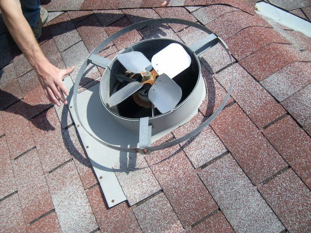

      2. cargin | May 06, 2009 03:11am | #26
        All
        Problem solved
        Thanks to IMERC I discovered that these fans should have a lid.
        Of all things. Well I special ordered one with a thermostat/humistat.
        I specified that this time I wanted a lid on it. I put my foot down. I wasn't going to get fooled again.
        I wired it up live, and installed it from the roof only.
        I just happened to have a part bundle of these red/white shingles in my basement from the last time I had a hard time finding them.
        And yes I have 4 exposed nails at the bottom. I covered them with gutter caulk. I also use gutter caulk (or urethane) on exposed nails on cap. I find that silver color blends with most colors, or looks like bird poop.
        Thanks for all your help.
        Rich  LOL

  13. Piffin | May 05, 2009 11:09pm | #21
    Bottom edge of that flashing looks lifted and loose, meaning the nails in it are loose in the decking.
    So when wind blows, water is under there finding a way in.
    Also possible at top of valley opposite - something looks goofy over there.
