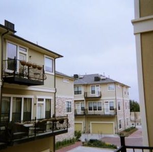

I am in the planning stages of a 37 unit townhome project just outside Nashville TN, because of the size of the lot and the look that we are trying to accomplish I was hoping to install the A/C condensors on the roof.  Most likely the Bryant Ultra Compact Preffered Series.  The picture is of a development outside of Dallas TX but I do not have any details such as how the access works or how they framed the opening.  Just looking for any advice as to what may be some of the potential problems.

    Noise, vibration, service access. Efficiency may suffer if the utility "well" in the roof is to deep, blocking airflow.
    Wait... Those blobs on the top are the AC units?? How ugly, even for cookie-cutter apartnemts. Can't they be hidden behind the mansard?

      The Bryant unit that I was looking at is extremely small, less than 15" deep and it can be as close as 4" from the wall.  They are also extremely quiet.  I was thinking I could disguise the well with iron railing.  I am open to other ideas there is just no where to put them on the ground.

        Talk to whoever is going to provide your service work on those units. Not the owner of the HVAC company, but the guys that have to climb up there with a bucket full of tools, gauges, freon tanks, hoses, etc.
        Now think about them working safely and efficiently. It is not going to happen in the units in the photo or anything like them.
        Like Dan suggested. Flatten the roof out and put a mansard around the edge.
      Shoot, around Dallas, those are "upscale" (you can ask the leasing agents).  They have fancy iron railings, and garages, too! (that's probably another $750 the month right there).
      The fact that the property owners stuck a/c units where they can barely be serviced will be balanced by the fact that they probably bought the least-sized, smallest-priced unit anyway.  (Probably sitting on the cheapest possible shingle, too.)Occupational hazard of my occupation not being around (sorry Bubba)

        This will not be a cookie cutter development.  The purpose of this is not to reduce cost or make it difficult for the HVAC contractor.  As I said earlier the units that I am hoping to use are extremely small and efficient.  I am planning on having amble room for service work, a wrought iron rail for safety and to help disguise the look and access from the attic space.  It is not going to look anything like the picture I posted from Dallas the picture was to just give some idea of the concept.
