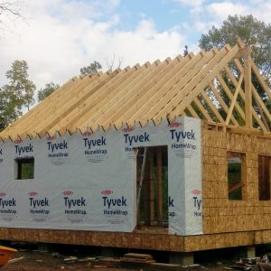

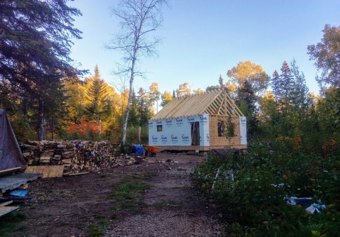

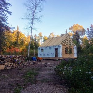

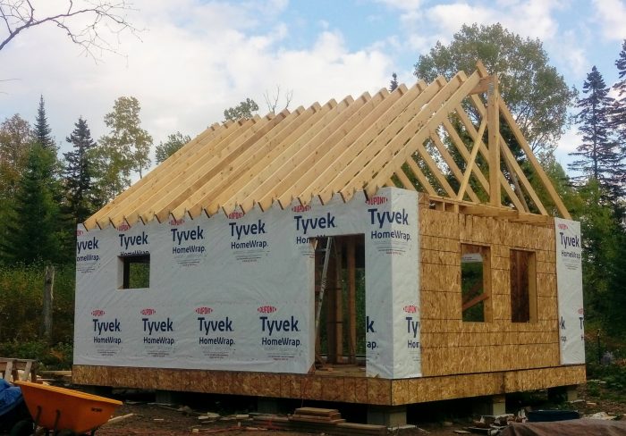

My husband and I are self-building a 20×24 home in far northeast Minnesota. We didn’t know the first thing about building a house, and have been learning along the way.
We’re at the roofing stage, and boy, do I have questions.

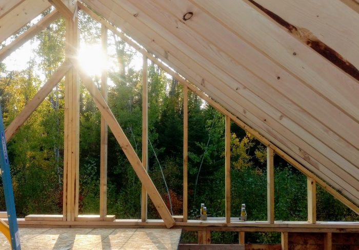

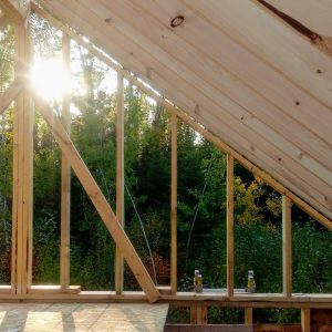

We have a half loft, which means cathedral ceilings. Our rafters are 2×8. (Had we known the amount of insulation we’d need, we’d have gone with 2x10s, but it is what it is now.)
What is the least complicated way to insulate the roof while still allowing for necessary air flow, etc? We are seriously racing against the weather here right now, and time is absolutely of the essence.
I should also mention that it needs to be DIY friendly. It’s really hard to get anyone up where we live to contract out to because our nearest large city is 2.5 hours away.
Attached are some pics of our build.
