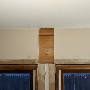

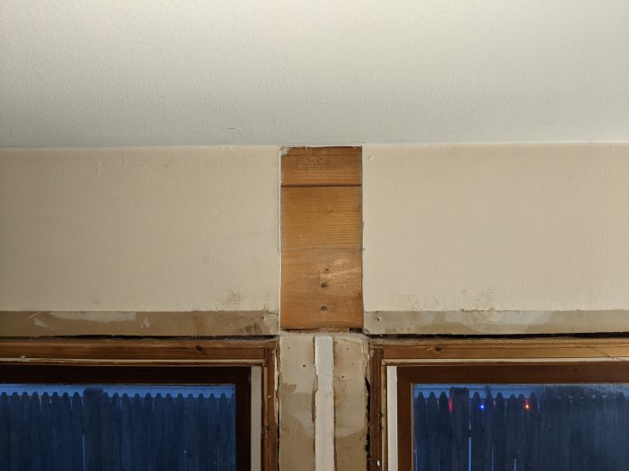

  3. smtwenty | Dec 19, 2020 04:28pm | #3
    Thank you @deftandlevel and @UncleMike42 for your replies. I'm back on this project again and cut a small bit of drywall from the middle section of the header in question.
    The header appears to be a single timber as I see no joint and it measures about 7". With that I'm assuming is it is double 2x8 running the full 6' distance. Should that be enough?
    1. calvin | Dec 19, 2020 05:08pm | #4
      Yes.
      And when you reframe the area under, place a stud directly below the double to the new plate. You can work on your beetle above if a 2 story.
      1. smtwenty | Dec 20, 2020 09:59am | #5
        Perfect. So I do not need to build any temporary support when I cut out the rotted section because that header is already supporting all the weight over the entire 6' span?
        1. calvin | Dec 20, 2020 10:22am | #6
          I would not, just level that plate under the windows and while opened up, recheck level/plumb of the windows. Reshim if necessary and check operation.
