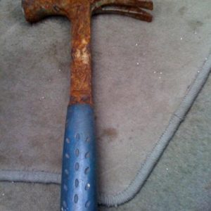

Trivial question perhaps, but how do I get the rust off this hammer?  I was thinking steel wool ….
The back story is somewhat amusing, at least to me.  I was replacing stairs last fall at a rental I own, rushing to finish before dark but didn’t make it.  Groping and stumbling around to pack up my tools, my hammer was nowhere to be seen.  I went back the next day to look for it in daylight but no luck.  I assumed that it had fallen behind the stairs right before I nailed off the risers with my finish gun … no way I was going to disassemble the stairs to search, but it’s been bugging me for 6 months – I liked the hammer.  Vowed to pound nails with my forehead rather than buy a new hammer …. fortunately haven’t acted on that yet!
Today I went to collect the rent in the daylight, snow is gone and voila – there it was, just laying in the grass next to the stairs.  AND the tenant paid up.  Cause for celebration.
So … suggestions? (for the hammer, not the celebration – I have THAT covered)
  1. Piffin | Mar 23, 2009 03:16am | #1
    stand it in white vinegar overnight.
    Rinse it off.
    Then go use it.
    If it needs more help, a wire brush wheel

      I keep a wire wheel on a little grinder just for tools that are left out here on the coast.My one friend uses M$%#^$# acid, See i cant even bring myself to write it!!!!
      1. Scott | Mar 23, 2009 07:40am | #9
        I've had success with what bobbys does.... an air-powered die grinder with a brass wheel works well.Scott.

    Pound 150# of spikes with it. It will be shiny clean.

    Naval jelly.  Can find it in any hardware store.  Remove the loose rust first.

  7. geoffhazel | Mar 23, 2009 09:38am | #10
    That model's my main hammer -- been in use since 1979. I third the motion for wire wheel on a grinder or even a drill. Get the worst off and start using it.
    Buff the face of the head with a belt sander.

    Try the battery charger method, attaching clips to  hammer and metal  in pail of solution. I can't remember the whole method, but should be able to Google it.
    1. jimAKAblue | Mar 23, 2009 04:34pm | #15
      sodium chloride?
      I don't remember but I know its a salt solution of some kind.
      I just met a guy that buys old cast iron pans and cleans them up that way. He says it strips the metal to the core and they will re-rust very fast if you don't treat them

    What Piffin said. Vinegar overnight.

    Ya gonna have serious rust pit no matter what.
    Le's see Fe2O3, FeO2, or whatever, what eats that?
    Recall Fe2O3+HCl = whatever, it eats it off, leaving water and ferric or ferrous chloride - you can then use to etch circuit boards with?
    Fe2O3+H4C4O2  (vinegar, or is it h4C2O2, cant remember)  = water plus some other junk that aint rust anymore. Kinda slow, not really reactive as vinegar is only 4% acid or so.
    Fe2O3 + NaOH, my favorite for removing rust. Throw in some old pieces of zinc car grill pieces (old car grills) --  Chem classes getting old, cant recall all this stuff, something about OH REALLY loving to get ahold of another H to make water, the zinc getting into the act big time  - go google it yourself if interested.  Leaves everything bright and shiny even if pitted.  If ya gonna solder steel, boil it in lye with a few pieces of zinc.   Is Naval Jelly is lye and zinc??  Go google MSDS on naval jelly, tell us wut you find.

      OK - checked naval jelly on wiki - here's what I found:
      Phosphoric acid, also known as orthophosphoric acid or phosphoric(V) acid, is a mineral (inorganic) acid having the chemical formula H3PO4. Orthophosphoric acid molecules can combine with themselves to form a variety of compounds which are also referred to as phosphoric acids, but in a more general way. The term phosphoric acid can also refer to a chemical or reagent consisting of phosphoric acids, usually orthophosphoric acid.
      Rust removal
      Phosphoric acid may be used by direct application to rusted iron, steel tools, or surfaces to convert iron(III) oxide (rust) to a water-soluble phosphate compound. It is usually available as a greenish liquid, suitable for dipping (acid bath), but is more generally used as a component in a gel, commonly called naval jelly. As a thick gel, it may be applied to sloping, vertical, or even overhead surfaces. Care must be taken to avoid acid burns of the skin and especially the eyes, but the residue is easily diluted with water. When sufficiently diluted, it can even be nutritious to plant life, containing the essential nutrients phosphorus and iron. It is sometimes sold under other names, such as "rust remover" or "rust killer." It should not be directly introduced into surface water such as creeks or into drains, however. After treatment, the reddish-brown iron oxide will be converted to a black iron phosphate compound coating that may be scrubbed off. Multiple applications of phosphoric acid may be required to remove all rust. The resultant black compound can provide further corrosion resistance (such protection is somewhat provided by the superficially similar Parkerizing and blued electrochemical conversion coating processes). After application and removal of rust using phosphoric acid compounds, the metal should be oiled (if to be used bare, as in a tool) or appropriately painted, by using a multiple coat process of primer, intermediate, and finish coats.
      Elsewhere, found this:
      A simple and inexpensive way to remove rust from steel surfaces by hand is to rub the steel with aluminium foil dipped in water. Aluminium has a higher reduction potential than the iron in steel, which may help transfer oxygen atoms from the iron to the aluminium. The aluminium foil is softer than steel and will not scratch it, as steel wool will, but as the aluminium oxidizes, the aluminium oxide produced becomes a fine metal polishing compound.
      Lots of hits on vinegar and rust but no scientific explanation ... seems that all acids work more or less the same ...
      Will post results soon ...
    2. Piffin | Mar 24, 2009 12:57am | #24
      I think naval jelly is phosphoric acid.All of these acids work -somebody said muriatic and hydrocloric each, - they are faster but can be scary, depending....I'd hate for somebody to dip it in muriatic and leave it too long, forgetting it, or have the cat knock it over and spill the stuffThe vinegar is mild, cheap, safe, and most folks have it at home

    WD 40 and steel wool or even aluminum oxide sandpaper.  I have never tried any acid methods.  WD seems to work great for a nice touch up in the spring when all hand tools are suffering from the winter abuse.

    I like CLR for that sort of thing, soak it overnight, and polish it up with some steel wool.  Like new.
