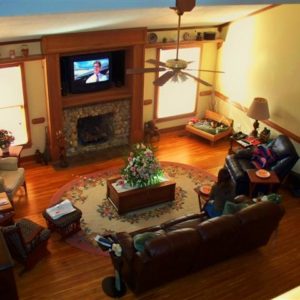

  5. frenchy | Nov 06, 2009 03:45pm | #8
    That's exactly what I did and there is a fortune to be saved if you think outside the box..
      For example the cheapest low grade hardwood flooring I've ever seen is about a $1.00 a sq.ft. It's pretty rough!
     I only paid 17 cents a sq.ft. for mine..   What I did was bought what wasn't fashionable at the time (darker woods like Cherry and Black walnut). My local sawmill has stacks of them sitting around without a buyer so he sold it to me for  what he would get by selling to the pallet mills..
      Now If I was really worried about every last penny I could have bought what are called slabs  A bundle of slab wood costs about $20.00 here and has about 500 bd.ft.  that's about 4 cents a bd.ft.   Now 50% of that will be waste so your real costs will be closer to 8 cents a bd.ft.
       That or thins.. I can buy 1000 bd.ft. of thins for $25.00  thins are boards of less than 1 inch thickness.. Wonderful for walls and trim.
       Bottom line? I paid $25,000.00 for all the wood it took to build a 5500 sq.foot double timberframed house ( a total of 50,000 bd.ft.) by buying direct from a sawmill.  Because you don't normally think in terms of bd.ft. That's enough wood to build everything made out of wood  in about 10 normal sized houses.. Flooring, walls, subflooring, cabinets and etc..
     By the way all of that wood is hardwood.  Black walnut 45% white oak 40% cherry, rock maple, and various other hardwoods total the remaining 15%
      The whole trick is to buy direct from a sawmill and not from a store or lumberyard!
     There are at least 10 price increases from the sawmill to the store.. Cut out all that and the savings is monumental!
     There are other things to do if you're interested..
