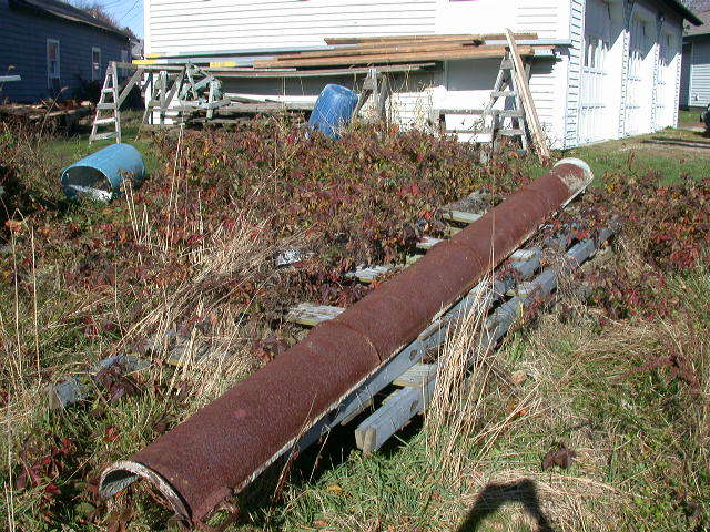

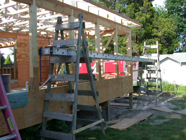

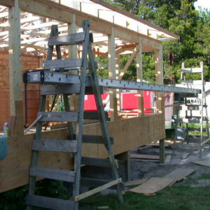

  3. xMikeSmith | Nov 18, 2003 06:06am | #3
    we use trestles , along with all kinds of other staging.. we have a pair of 8' trestles ( see pic )  and 10' trestles..
     they work great with 24' pics.. we also use pipe staging, baker staging, and alum-a-pole..and  lots of saw horses
     i don't think i would double stack any of our saw horses, though

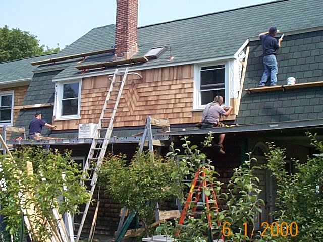

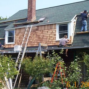

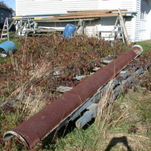

          1. xMikeSmith | Nov 23, 2003 08:48pm | #14
            Stephen.... my 8' trestles (  a pair ) were built in  '75... i've replace a coupl cross pieces over the years.. one man can pick them up .. 2x4 pt legs, 1x8 ledger board cross pcs...
            some guys build them  so one leg is plum and the other splays, so you can set them closer to the house.. we used to make the tops with enough room between the uprights for (2) 2x10 planks...(now we'd make sure our widest pic would fit)  and the bottom slightly less than 4' wide so they will fit in a pickup truck.. usually 16" between the cross pieces..
            my pair of 12' trestles take two men to pick them up... same width dimensions as the 8'....
            you can always tack a brace to the ground to give them extra stability
            nothing is faster for staging than a pair of trestles and a 24' pic...and of course , 3 trestles will give you 48' of staging
            here's how they usually get stored.. this is the 12' ( steel studs with pt inserts )
            and  a pic of the 12's in use on a siding /roofing job
            and a pic of the 8's in use working the roof frame
