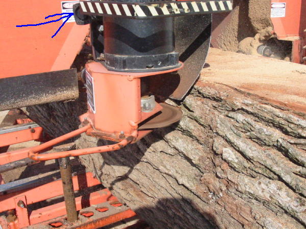

Up next is the debarker, it does what it says. It also gets rocks and other junk out of the way of the blade. This is an optional equipment that pays for itself by keeping blades from having to be resharpened sooner.

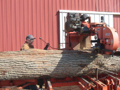

Here is a log loaded on the mill ready to start cutting.

Heres a bigger log, oak if I remember right. We can cut up to 36" diameter, but it gets really difficult when positioning the log and turning it when they are that big.
A stright-on view from behind the blade. This log was crooked, so I had to open the throat on the saw up all the way.

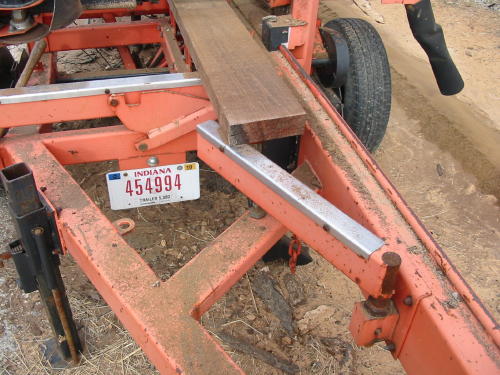

Here is a picture that shows the log support arms fully raised. There are actually four of them, and we put rollers on two. The rollers help turn the logs easier.
Sometimes we get help loading the logs. The guy we were cutting for brought his green tractor with front loader. We have used bobcats in the past, but this setup is much better.
The tractor with forks was also nice to have on this job because later we cut some 6"x12" beams, I believe they were 16' long. Beams that size are hard to move around, especially wet oak, and dangerous also.

Nice. Most guys around here take the time to chip away the bark where the saw will go (unless they have a debarking unit) so that dirt and stones don't wreck the blade. Have you had any problems?
Scott.
I haven't had any problems with the debarker, it cuts a good size groove and knocks away unwanted junk. I am usually concerned more with dirt than rocks, but the debarker takes care of that in short order.
Mitchhttp://www.freewebs.com/glenndalepedalplane/
I found a close-up pic of the debarker in the wood and running. The arrow points to an alarm(back-up beeper) that lets people know it is turned on. Whenever the carriage is in the forward movement position, the debarker is running(as long as the switch is turned on). I can hardly ever hear it because of the engine noise and I wear earplugs at all times.

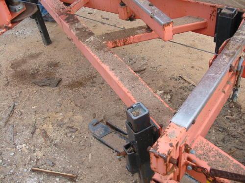

In this picture, you can see the black leveling posts on the mill. There are six of these total-one front, one back, and four mid-machine. These allow us to set the mill up flat. And I learned the hard way one time to always put the front one up after hooking to the truck at the end of the day.
