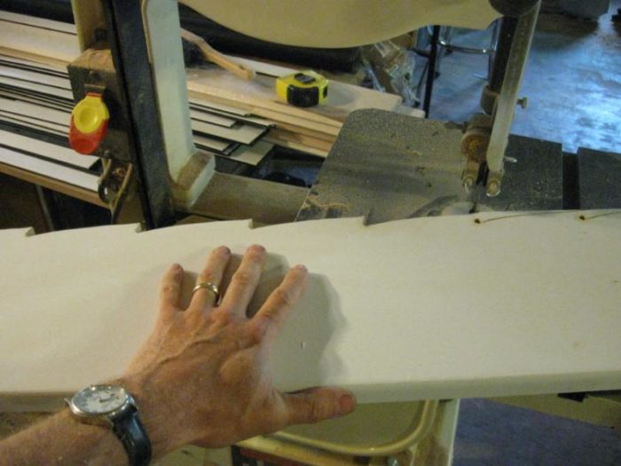

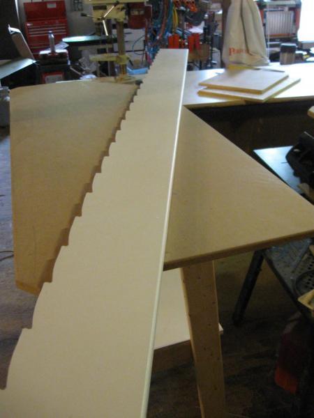

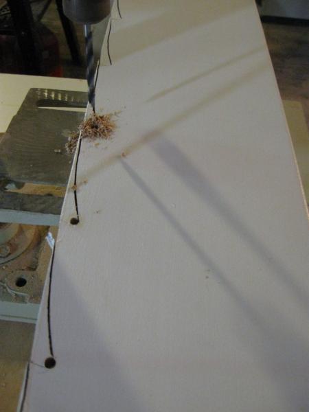

This afternoon I had an interesting chore… scribe a 1×8 to fit against some existing siding. I story-polled it on site and then dropped by the shop and used a band saw and drill press to cut the profile. She fits nice, primed it this evening and will paint it, install, and caulk it tomorrow:

It is a condo overlooking a lake, and bordering a wildland park... but clad in vintage 2001 vinyl. Condo assoc. rules prohibit any penetration of the building exterior, so the screen porch work I did needed to be scribed to fit.The scribing only took about an hour, so about the same price as cutting in J-channel.

My opinion is that my answer to you question will be of dubious value, as you might work faster or slower, work in a different market, etc.I mentioned 1 hr. and that is how long the shop work took me... here is the rest of the story... I also stopped by the lumber yard and grabbed a sample of the Certainteed siding used on the building to trace onto the board (but I was already going to that supplier for a contractor lunch, and met a guy there who needs some alder to trim some windows which I happen to have in stock at my shop so I made a sale there also), then I hit the shop (needed to build a custom jamb and hang a door in it at the shop anyway). The shop work went fast for me because I have good infeed/outfeed support for my band saw and use a pool cue stance for feeding the board into the band saw that makes cutting curves fast and accurate and a drill press makes short work of 17 holes.It took 5 minutes to test fit and take 1/16" off of three teeth with a sanding wheel on a grinder and 30 min to prime and paint the scribed edge.I'll bill the customer for 2 hours @ $50/hr., $25 for the lumber, and might get paid for an article I'm writing on this screen porch project too. The scribed board does make a nice hook or sidebar for the article. That is not why I did it, but it could help me there. I bat about .500 with getting stuff I submit published...Lots of variables unique to each situation.
