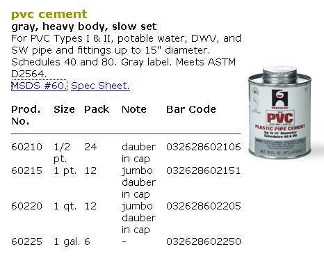

            The grey cement is also approved for potable water...
            Rudeness is the weak man's imitation of strength. ~~ Eric Hoffer
