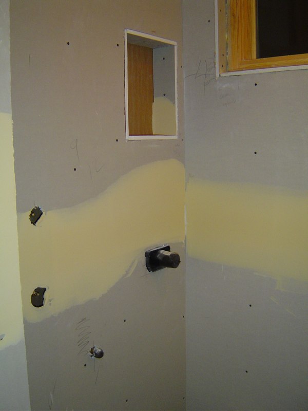

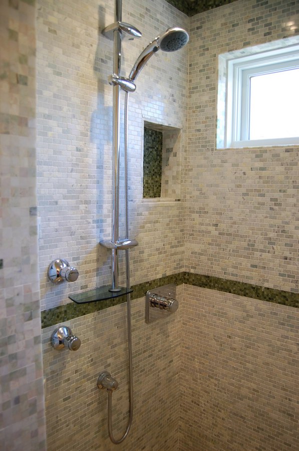

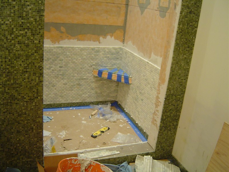

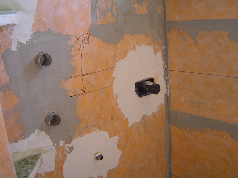

          3. paulwaterloo1 | Jun 15, 2007 01:25am | #15
            You are right.....I thought the same things.....ran the Kerdi into the openings.....and there are good gaskets on the Grohe stuff I bought......
            I knew you were joking!
            Sometimes I post and read here and realize that since most of the things I do are for the first time (and a lot the only time)......that I am wrong in my "perfect" method.
            The wall around the controls doesn't hardly get wet at all when you are taking a shower....
             View ImageYou can see where I put patches around the openings, I folded the Kerdi over the wallboard for the same reason you state. I should probably just post naked pictures of my woman in the shower and call it a day! :-)View ImageView Image
            Edited 6/14/2007 6:30 pm by PaulWaterloo
          4. john_carroll | Jun 15, 2007 02:12am | #16
            Very nice tile work, Paul. I have no doubt that it's impervious to water from inside the shower. However, the supply lines are on the other side of the substrate from the membrane. I would rather spend a few extra dollars and a few extra hours for a cement-based substrate, in case there is a problem in the plumbing.
            Like you, I used Grohe fixtures. One of the nice features of the mixing valve I used is that it can be accessed from inside the shower. When the shower head dribbled rather than flowed, I found that debris from the supply line was built up in the screen at the valve. (Words of advice: Never use whole wheat bread to plug the supply line during a plumbing rough-in!) The repair was straightforward but about a gallon of water ran over the edge of the cement board. I was glad it wasn't gypsum.

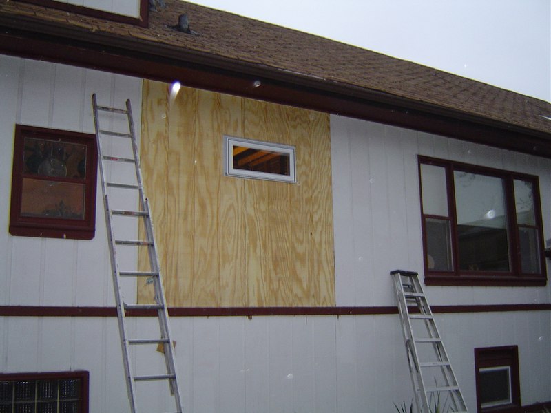

          6. kjblunck | Jun 15, 2007 06:31am | #20
            Paul,
            Great shower.  I have a question for you regarding the window.  My shower renovation project also has a large window in it and I am trying to figure out what to do with it.  I don't need an operating window, but I can't really do away with it without re-siding my house.  I noticed in the original space your window was wood, possibly trimmed in oak.  Did you replace it, and if so with what?  When I talked to the window guys they made it sound like neither vinyl or aluminum painted very well and I really don't like the idea of a wood window in a shower.  Even painted, they ultimately always peel...Any suggestions?

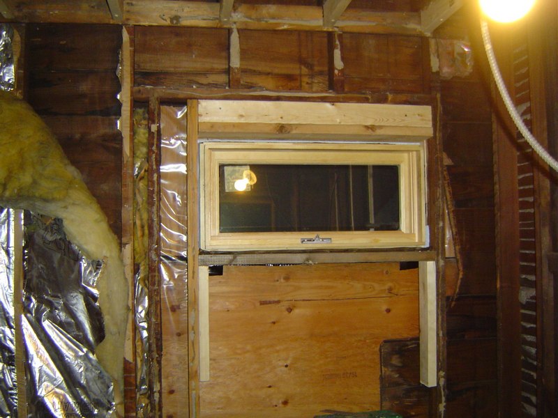

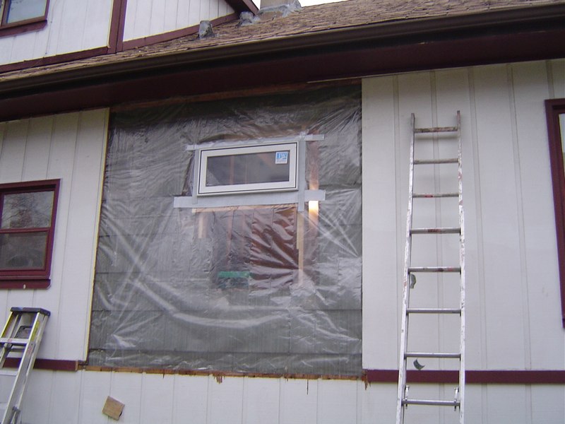

          8. paulwaterloo1 | Jun 15, 2007 03:45pm | #22
            The window you see installed is a new window, not know much about windows (and knowing a wanted a good, quality wood window, not vinyl), I bought a Jeld-Wen AuraLast window. It's alumuinum clad on the outside and wood that is treated on the inside, guaranteed to last 20 years.
            http://www.jeld-wen.com/windows/wood/builders/product.cfm/product_id/177
            I painted it with one coat of oil based primer and then two coats of oil based paint. It doesn't get water in the jamb, due to its location.
            I had a cheap owner who lived in my house before me, so I have T1-11 siding on my bungalow, I replaced two panels during the install.
            This replaced a glass block window from before. The location of the glass block window is now where the wall with the shower controls jets out.
             View ImageView ImageView ImageView ImageView Image

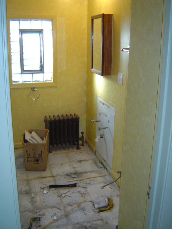

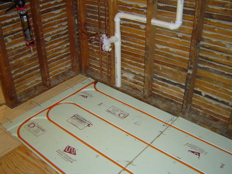

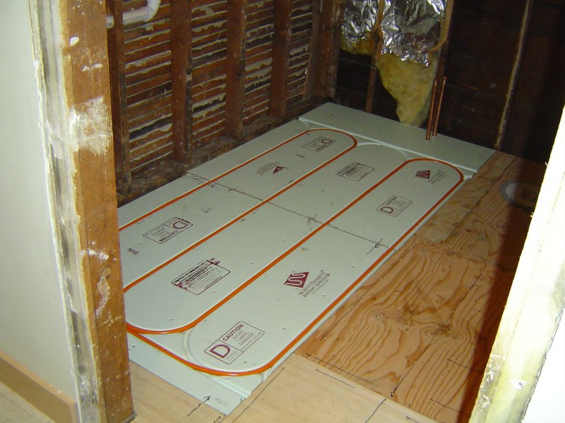

          10. paulwaterloo1 | Jun 15, 2007 07:47pm | #24
            Relatively cheap and realitively easy? In floor heating with electric mat. It keeps the floor warm and it doesn't necessarily heat the room, but if adjacent rooms have heat, you are good to go, especially with a window like that and new wall insulation. My bathroom was super warm this winter (more so than the last two with the old window and leaky vent on it) with NO heat on. But you will need a new separate circuit for it.
            I installed warmboard, but will have to hook it up some day.....when I redo the adjacent kitchen and remove the radiators, I will be hooking it up.
