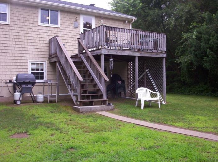

I’m having a design challenge here.  I have a customer who wants to cover and screen in an existing elevated deck.  A neighbor has a deck built very similar to what they want.
The other deck has a short kneewall (about 24-30″ high) and then full screen to the top of the wall with no other visible guards.  Here in Mass I’m pretty sure code requires a 36-42″ high guard with no spaces larger than 4″.  I know they can’t be counting the screen as a guard.
The customer wants the kneewall as a visual element to make everything have a more finished look, which I completely understand.  However, because of the deck’s elevation, they want to be able to see down into the yard without having to get up from their seats.
I suggested the traditional balustered railings to improve visibility and still maintain proper railing height.  However the homeowner didn’t want to have to take screens off to paint balusters and doesn’t want to spring for composite materials either.
I asked the town inspector and he confirmed he’d insist on a 36″ minimum railing or kneewall.
Any ideas on how I can improve visibility, meet code, and have minimal maintenance?

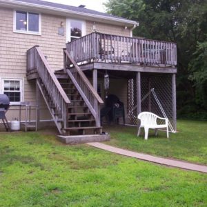

Attached is a pic of the existing deck.

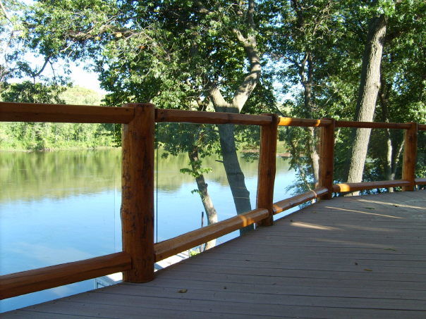

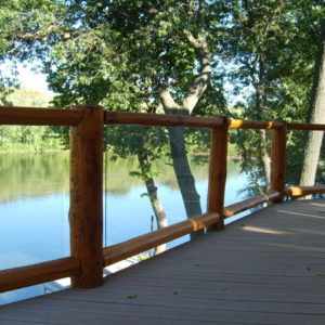

    See if glass below rail height and screens above will work. You can pay big bucks for the glass or recycle old patio sliding doors (turned horizontally) for that application.
    Here is a rustic log rail with glass, for inspiration:
