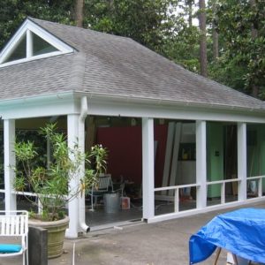

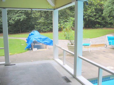

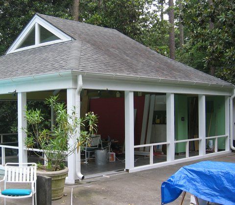

I am a relative novice completing a complete screen porch refinishing. Design is simple series of “bays” separated by 6×6 columns. Fixed screens will be installed with rectangular stops. (see attached photo).
Orignal plan was to install sliding screen doors to handle entrances. My issue is that the design police have asked whether we can install double, outswing wood screen doors instead of sliders. Of course the answer is that anything is possible, but I want to find a simple, affordable solution that is works for someone of my skill level.
I’ve reviewed Katz’s book on doors, which offers lots of ideas, but not directly addresing my conditions. Here’s what I am thinking, but I would really appreciate any reactions/improvements:
1. Since RO’s (width) are completely non-standard, can’t use pre-hung (and not sure where I could find them anyway) (Two door sets: one 66.5 and second 68.5)
2. Plan to buy inexpensive wooden screen doors from local yard — stock 32 should work for 66.5; haven’t figured out how to handle second door (stock = 32 and 36). Will buy basic open rectangle and add horizontal stock to loosely match porch design.
3. Will mill jambs, using standard 3/4 and 1 1/4 dimensions. (can I buy these premade?)
4. Not sure of appropriate width for jambs (columns are 6″) and best way to finish the ends since they need to be shimmed to the columns. (My assumption is that I want approx 3-4″ jambs to maintain the appearance of the columns
5. Threshold/sill — something simple, but need ideas and material. Lip is 3/4″
Thanks for any help. Glad to provide additional detail. Fully understand if this is too big a request or candid feedback that I’ve lost my mind even considering this part of the project.
