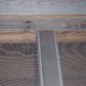

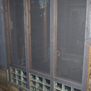

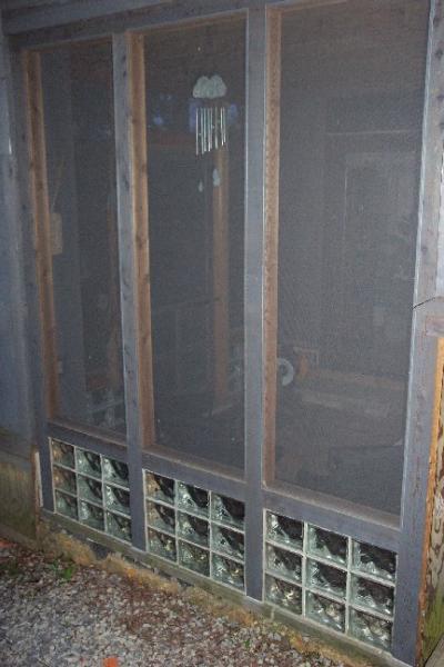

    I used a spline in the groove to screen in this porch.  Did the routing in place as the framing was already in.  Needed a jig for the corners, the guide on my laminate trimmer worked for the straights.  I sized the spline for the bit, several sized spline stock available.  Here's a shot of the porch.
