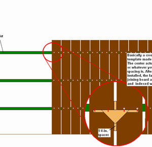

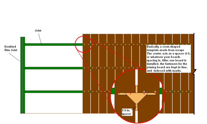

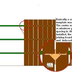

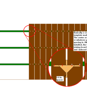

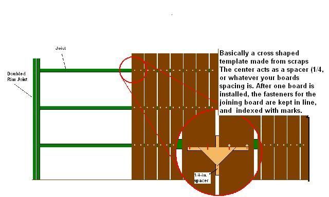

    JFink | Mar 29, 2006 06:25pm | #15
    Try this:
    Justin Fink - FHB Editorial
    1. FHB Editor
      JFink | Mar 29, 2006 06:33pm | #16
      Sorry about that, here's a resize...Justin Fink - FHB Editorial

      JDRHI | Mar 30, 2006 06:27am | #27
      Not too shabby there Mr. Fink.
      We gonna see that one in the Tips & Techniques of an upcoming issue?

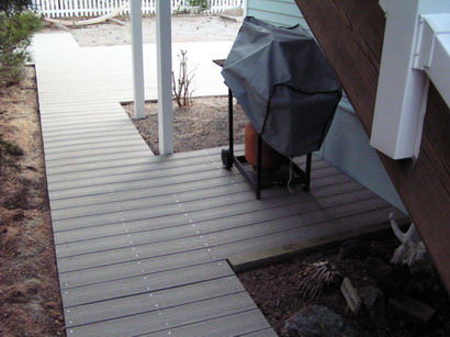

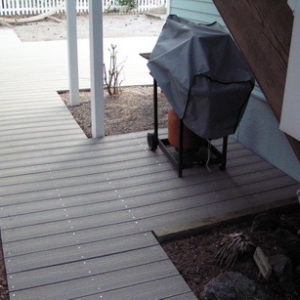

  10. KevinH | Mar 29, 2006 07:24pm | #18
    Conceding of course that I am pretty anal-retentive about such things - on the couple deck jobs I've done, I've run a tight string line along each joist.  I then just make a small dot with a Sharpie a known distance (combo square blade maybe) in from each board edge.  This is a very quick procedure - not quite as precise as it may sound.
    After marking a bunch it's off to the races with the screw gun.  Then just mark some more screw lines while the gun is cooling down.
    If your screws show at all - it does tend to make a big difference in the final look of the deck and it really doesn't take too long to do.
