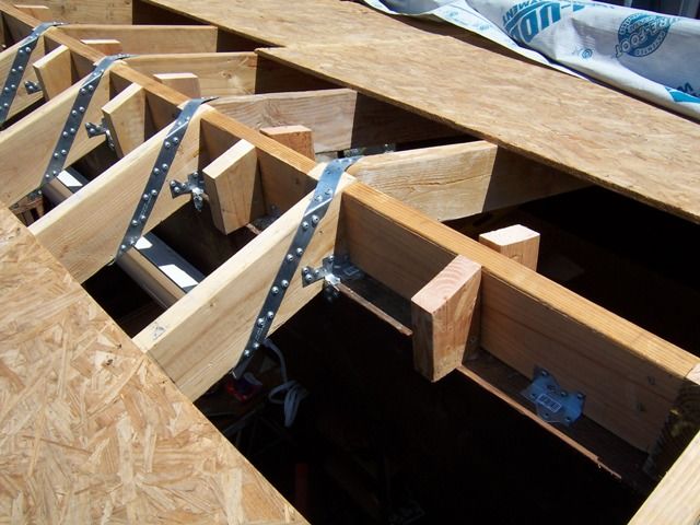

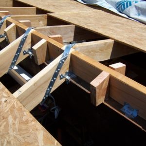

Paul, What's going on there? You can't just post a picture like that and leave us hanging.
My guess is those straps and the other brackets are for wind and/or seismic reasons. The screws are likely Strong Tie brand SDS screws. They aren't your run of the mill drywall screws.
Here on the West Coast, mostly west of the cascades and the Sierras. seismic and wind potentials brought about the strapping of rafter pairs over ridge boards and a host of other financial benefits to Simpson Strongtie.But I've never screwed them down. Don't want to. Don't need to. Don't have to. Don't have time to. Getting to gimpy in the knees to.I am an Animal
That is an example picture of my rebuilding my garage.
Like all DIY projects it started small "I'll only have to replace these two rotted rafters" and ended up being "Lets add 12" to the wall height and replace ALL the roofing!" OI!
Since I wanted to minimize any design related aspects, I cut the new rafters exactly like the old ones were - I figured they were cut that way for a reason. D'OH! I should have extended them each past the ridge beam and cut them on the plane of the opposite rafter. Thats why that strap is there wrapping around each side in a spiral.
I added a ridge vent and more block vents at the sides. Since it was on 24" centers I didn't want there to be a soft spot near the top, so I added that 2x4 angled blocking in the center for support.
For fasteners, I used McFeely's #10 1.5" Round Washer Head with No Corrode galvanized finish, #10 x 3" ProMax Round Washer Head No Corrode galvanized finish, and #9 3.5" Phillips DeckMate Square Driv. Sheathing attached with 2" Senco exterior gun screws. My tools of choice for this were the Ryobi 18v impact driver and angled drill, and the Rigid 12v drill and angled impact driver. I think I dropped that Ryobi impact driver on the concrete - from the roof - dozens of times. Just replaced the bit if it got bent in the fall.
All inspected and approved by my local BI, though I had to get the head guy there to personally check it out and really look at what I was doing.

Joe it's strength is a by-product of the look I wanted to achieve.. Some may decide between cedar shakes and hardieplank.
I decided that black walnut beams and stone would look good on the outside. While I still wanted to look at a timberframe on the inside.. so the inside timbers are white oak the outside timbers are black walnut and there are SIP's in between which are 200% stronger than stick framed walls..
Massive over built? So what, it wasn't expensive..
If you haven't seen my place you can do so at 85891.1& 94941.1

Mike, have you installed some of that sureboard yet? If so, can you describe it? Bob's next test date: 12/10/07
Yes. It is basicly a piece of 5/8"sheetrock or densglass (exterior) with a piece of 20 guage sheetmetal on the back. Similar to the lead lined board used for x-ray rooms etc.
A special screw is used and it must be screwed to specs required. Usually cut with a skillsaw although we try to special order to length for minimal onsite cutting.
It is heavy but not unmanagable. I was surprised to see on their website that it is used on wood framing.
We have used it on a few light guage steel multi-story condo projects similar to those pictured in their website.
I am amazed at the rate this thread is going! As time goes on there is becoming more hybrid construction, blurring the lines between wood and metal construction. Mike
Your information in your last post is the only worthwhile info in the last 400 posts in this thread. I've just been in here harassing Frenchy for fun. Do you know if the product is cost effective or just another "improvement" that does the same thing but cost more? Bob's next test date: 12/10/07
By the time we start some of these projects they have been "value engineered" extensively. A lot may have to do with speed of assembly because of labor costs, and everyone knows sheetrockers are faster (and cheaper) than anyone. ; ^ )
As far as I know, these type of buildings were started in the Northwest and are spreading out fast. I suppose if they are not cost effective then they won't last long.
Mike
