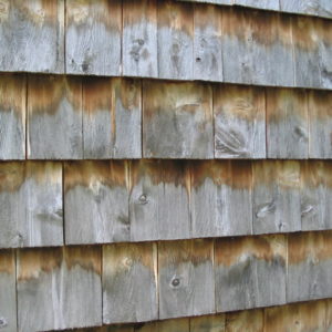

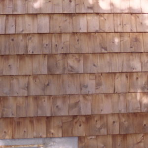

            Most any good paint supplier will have the 4" rollers. I don't know if the borgs carry them. They are open on one end and there are a number of roller sleeves that can be used on them. A popular one that you may see is a white foam with a round end. The cloth ones are like terry cloth, hold a good amount of material and last long on rough surfaces.As far as I know, all the Defy products are water based. I haven't used any of the roof products. They are supposed to be environmentally friendly, from the oxygen bleach in the cleaner to the top coats. These are not a solid colored stain. More of a clear or clear with a tint. It is an in the wood finish, not a film coating. Water resistant and UV inhibitors. I have a couple of pictures of white cedar shingles. I used the wash, brightener and UV clear, applied with the small roller. I just dunked the roller in a bucket and pressed off the excess. You have to be deliberate with your motions so you don't send drips flying. I had good application and control with the roller, going slow and allowing the product to penetrate, not a hurried back and forth rolling. I thought I got more product on with less mess than I would with spraying.
            jarhead2 | Mar 23, 2008 02:51pm | #14

            Jarhead, there should be a deck wash - oxygenated on the link I posted, middle of the page, right above the brightener. I followed the instructions. I applied the deck wash with a garden sprayer and stayed out of the hot sun, allowed it to sit for fifteen minutes, kept applying to keep the surface wet. I then scrubbed it with a brush and hosed it off with a gentle garden hose spray, not a hard stream. I think the brightener may contain a little muriatic acid. The shingles looked good with just the wash. Maybe I could have skipped the brightener but I didn't want to leave out a step. Many companies make an oxygenated deck wash.Beat it to fit / Paint it to match
