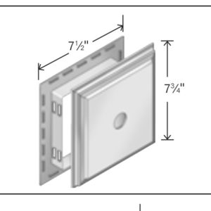

    As a disclaimer I am nowhere near the level of workman as many of this forum's regular respondants, but I will give you an idea of how I would handle a penetration like you show here.  To seal the penetration through the house I would utilize an elastomeric caulk that is ideally fire rated around the pipe at the house wrap ensuring good contact between both elements.  To provide a finished product the vinyl siding manufacturer should have a fixture block of varying sizes with cutouts that would match the pipe diameter and be color matched to your siding. If the spacing between the pipes is too small for the use of two fixture block often times the will have large rectangular blocks that could accommodate both pipes.  I would complete by sealing around the pipe at the fixture block with a thin bead of clear caulking.
