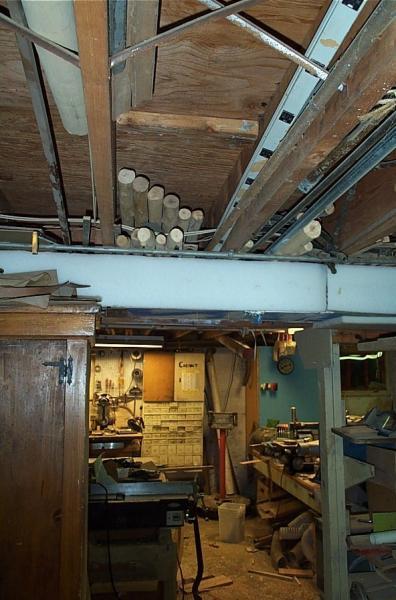

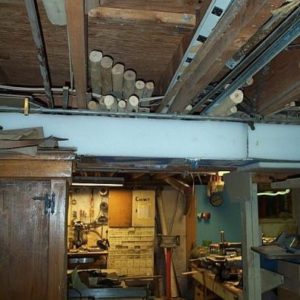

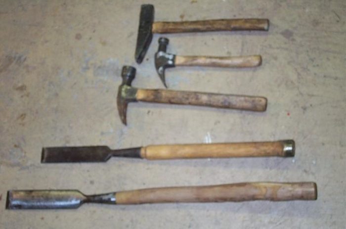

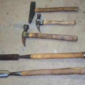

    Anyway, the first step may not be easy (Grandpa's 1910 method), but all my handles are either Illinois shagbark Hickory from undergrowth in the Sangamon river bottom (Boss knows where that is), or a few select pallet pieces found - assume are from TN.  Handles contain the pith at the center, the one I pick are > 15 YO and under 1-1/2 inch dia. Dry indoors for over 1 year (store mine on top the furnace duct. Drawknife to shape on a nice dry winter day, and rub with linseed oil every day for a week and keep in old oven in basement at 120F during that time (ya gotta love the smell of linseed oil).

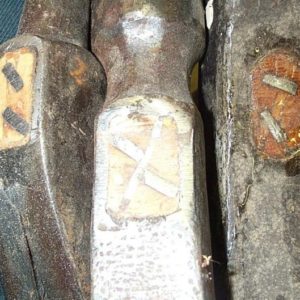

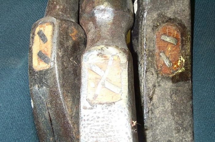

    1 inch deep diag cut in end, coat inside of hammer head with polyester resin, drive into head by whacking end of handle on an anvil. Drive oak wedge into slot with more resin for glue, drive in 2 each steel wedges diagonal to the wooden wedge.
    Pine tar on handle optional (esp roofing hammers).
    The attachments are self explanatory, a few item I had in the house vs garage or barn to grab a pix. (One slick handle is walnut - fit is only criteria there. )
