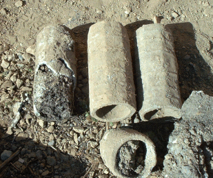

  8. justinbearing | Apr 28, 2006 03:38am | #19
    Here's what caused mine to back up.
