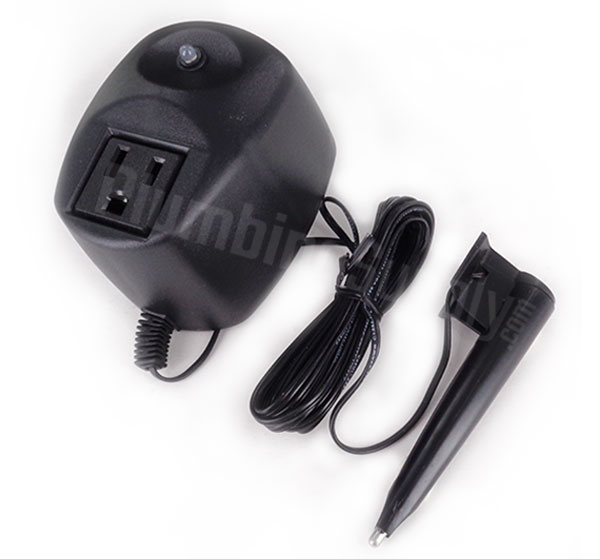

    I do recomend an electronic pump switch verses the old ball float mecury switch of old like this one from Sumpwatcher.

      Hi Bill,It's laundry and a bathroom. Toilet, shower, lav. Washing machine will actually not use the ejector pump. The package says it's good for solids up to 2". Not pushing it far, only about ten feet total to the sewer line, only about 6 feet of vertical lift.This is the specified unit:http://www.goulds.com/GP-Product-ID-263.aspCan the electronic switches be added to this particular unit, do you happen to know? Is an alarm important? This bathroom will probably very rarely be used.Steve

        Yes that sumpwatcher¯ will work with any plug in model lift station.
        Alarms can be overkill, but everyone that has water damage wishes they had an alarm.
