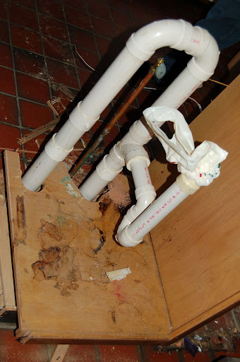

            Matt | Feb 07, 2009 04:55am | #31
            I went and googled loop vent and found the attached.  You are right - it isn't a wet vent.

            Matt | Feb 07, 2009 04:56am | #32
            pic didn't come through.  I found one though....

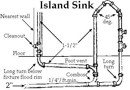

            Can you give us some details about venting of kitchen island sinks?
          9. plumbbill | Feb 11, 2009 06:35pm | #45
            The "loop vent" pic that you posted is almost correct.
            You do need to use a drainage fitting (combination wye & 1/8th bend) where the horizontal vent (foot vent) meets the vertical vent below the cabinet.
            Here's a pic from the UPC training manual that explains each section.
          10. User avater
            Matt | Feb 12, 2009 03:43pm | #47
            Thanks Bill.  I wonder if there has to be a certain vertical distance between the horizontal (under floor) vent run and the horizontal waste pipe shown below it in the pic?  Also, I wonder if that is gonna work with a slab house?
          11. plumbbill | Feb 12, 2009 06:25pm | #48
            Just like any other vent it has to come off the top half of the waste pipe.
            & yes that can go underneath slab on grade.

          13. plumbbill | Feb 18, 2009 06:33pm | #51
            We rarely put the cleanout on the bottom as the pic shows, cause that would usually end up being in the condo below the island sink.
            We put the cleanout on the vertical waste pipe below the san-tee & above the floor line. Here is a pic of what that would look like.
            http://www.theplumber.com/images/island.gif
            To my knowledge NC goes by the IPC which loop vents (AKA special venting for island sinks) are legal.
