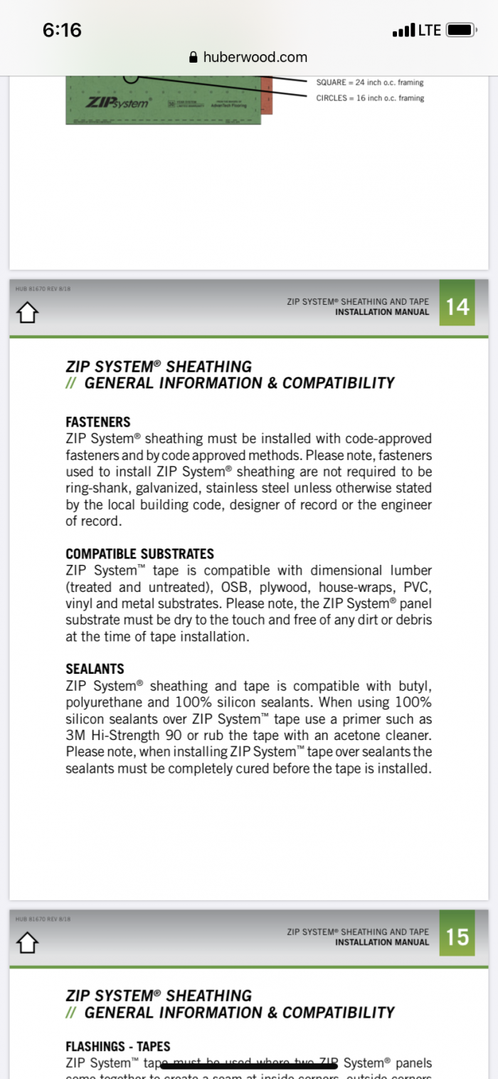

Thanks for the response Eric. When I did a google search I got the same information, however when I read the Huber installation manual for more details they actually do not recommend any specific fastener except to say that they should be in accordance with code.
I called the code officer and he stated as long as they are 8d he doesn’t mind and he doesn’t care about shank diameter ??♂️
