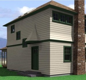

I saw a little house in a book, then modeled a version of it in Chief Architect, as an exercise to learn some new things.

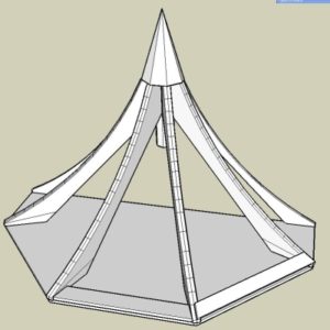

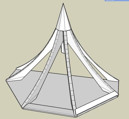

Over the entry door is a half-octagon canopy, shingle-roofed with materials to match the adjacent siding.  I did a workout in Sketchup of what I thought the frame might be.
The pic shows the frame.  It has a bevelsawn block into which the three curved rafters fix at top, then the whole thing bolts into a block embedded in the wall frame.
The top piece, the half-duncecap, is made as a block from layers of 2x lumber.
What would you recommend in the way of felt paper, housewrap, flashing, membrane, etc., to get this all prepped right for the shingle job?

    Do it in copper. It needs a WOW factor.
  2. Piffin | Mar 25, 2009 02:27am | #2
    Sphere is right. No sense building that degree of detail into making a curve and then making it blah to blend into the rest of the wall with the same shingles.
    But if doing it with cedars, I would weave the vertices the same way you do an outside corner in the siding.

  3. jimAKAblue | Mar 25, 2009 08:43pm | #8
    There doesn't seem to be any significant detailing needed to properly roof/flash that application. Whatever works with a "normal" roof will work there just as well.
  4. jimAKAblue | Mar 25, 2009 08:45pm | #9
    I've made those dunce caps with solid wood. At some point in my career, I stopped using them and just custom cut each rafter into the bunch. I think it's stronger to eliminate the solid wood.
