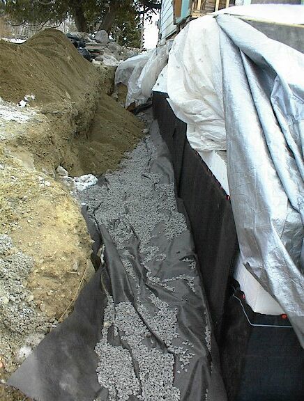

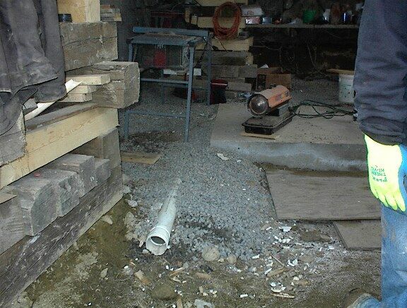

    Here are a couple demonstrating some of what Mike said. Two interior and one exterior
    1. plate | Jul 23, 2009 12:39am | #4
      Thanks for the pictures!
    2. DaveRicheson | Jul 24, 2009 01:39pm | #8
      What kind of fabric is that in the exterior picture?
      1. Piffin | Jul 24, 2009 04:37pm | #11
        A landscape fabric. We get different widths and weights, so I'm not sure which that is.There was stone surronding the drain pipe with fabric under it, then some hay over that, then the fabric, and a bit more stone weighting it in place. We used the hay on that one because it was mid-winter and we had to protect the footers from frost getting under for a while. Used curring blankets on and off during the process until backfill time.No fabric inside, like Mike mentioned, but we ran poly VB over the stone and under the slab.BTW, that perf pipe for drainage interior not only led to daylight for drainage, but had a gooseneck to vent outside above for passive radon venting

        I just got to wondering if you meant the fabric in the bottom, or the dimplematt with fabric attached for drainage plane on the wall itself?
        1. DaveRicheson | Jul 24, 2009 09:03pm | #13
          No, I ment the fabric in the bottom of the trench.
          I recognized the dimplematt on the wall.
