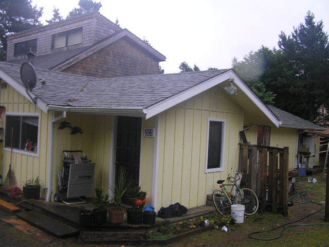

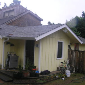

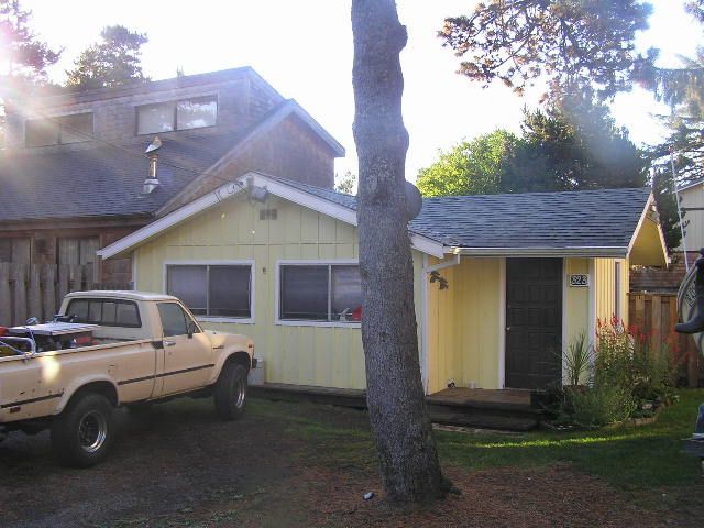

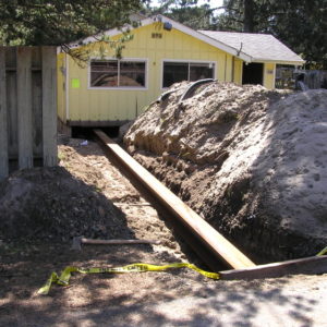

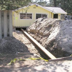

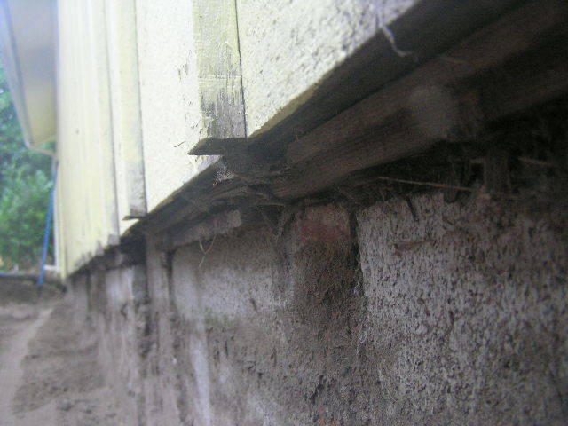

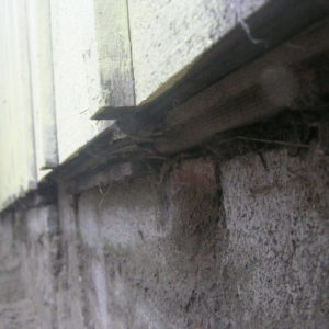

here are some photos of a house im think’n of lifting…or should i just level it.e.i. mow it down
i plan on changing the roof this summer too..
the foundation is bad…i guess? it has been shimmed over the years in some places 1 1/2 inches …it has a cyinder block style foundation that has not been filled with concrete..
the local lifter says 10 grand if i do the exavating and pour the concrete…seems high?
the house sits on a good piece of land ..is it worth it of should i just dry pack the gaps and troul a “patch over it”..
thanks for the imput
tj
  1. nailbanger | Dec 23, 2006 01:55pm | #1
    To say that the foundation is bad is kind-of an understatement!
    Let's see, you've got to replace the foundation, you're going to change the roof (as opposed to just reshingling?) which means messing with a lot of the interior walls & ceilings. What's left? I don't know what costs are like where you are but it sounds to me more like a call for a dozer than one for a carpenter. Plus, the end result will be what you want as opposed to some sort of compromise between what exists and what you want.

    Matt | Dec 23, 2006 02:50pm | #2
    What are the footers like under the block and how deep is the frostline in your area?  Do the footers go deep enough?  Are the soil conditions such that the footers aren't properly supported?   I guess there is defintely a footer problem?
    Is the crawlspace lower than, say 18"?  Are there moisture problems under the house?   Ie - would the house benefit from being higher?
    What about realestate values in your area?  Are they such that you might easily recoup investments in these major home improvements, or is the housing market such that the house might not be worth much more even with significant  improvements?  Looks like it might be near the beach?
    1. driftwood | Dec 23, 2006 07:57pm | #3
      yea the crawl space is under 18 inches..i dont have a moisture problem ,but the footing is only 7 1/4 wide 3 1/2 thick...not frost line here at the beach..the sand here compacts like concrete..and because of septic setbacks if i was to doze it i would be basicly putting up the same size house..on the same footprint..the only place i can build is out front...which can be tricky because as of now the road sit quite a bit higher than the house..the proptery is worth 320 ..i paid 320 for the house and proptery..it sets in a very desireable area on the north coast of oregon..dead end street 1 block from the beach.so i should lift it? or doze it ...the house was built in 1942 its sound ...
        Matt | Dec 23, 2006 09:20pm | #6
        I'm no remodeler, I do new houses, so I'll leave the how-to details to the pros in that area.  From your descritions though it sounds like the root of the problems are the footers, and it also sounds like you could easily get back the kind of money you are talking about putting into it.  In some economys doing major makeovers could be a waste but that doesn't sound like your case.  Here, but more on the cost, depending on the location, a house like you describe could be worth a half mil so doing the work would be a no brainer (I hate that term :-).
  3. davidmeiland | Dec 23, 2006 07:59pm | #4
    10 grand is what I paid to lift my house. I'd pay that again, I'd never lift a house myself. They lifted it high enough for us to walk upright underneath the floor joists and drive a small tractor underneath. It made the concrete work, carpentry repairs, wiring, plumbing very easy. From the look of your place I'm guessing there's a very minimal crawl space, and that doing any work would be miserable. When you're done you probably will not want to lower it all the way, so leave some money for new stairs and whatnot.
    One problem: a house on cribs is a curiousity and everyone will stop by and talk to you. Makes it hard to get anything done...

    The second set of pics from the crawl indicate pretty marginal consturction to start with - those look like some serioously overspanned 2x6s
    I'd take a hard look at the whole house and its detailing in making the decision.
    A gem on a crappy foundation might be worth it.
    A lifted POS on a strong foundation will still be a POS

    I can't see enough of the rest of the whole house condition to say whether to doze it or save it at all but I'll comment on jacking.
    It is well worth it to the house mover to jack it up fair price - because of site access and insurance concerns. Also,it looks like the floor joists are spread way far apart - maybe four feet, which makes me assume other weaknesses in the framing.
    but you could do it your self too. I jacked up a house like that about same size for 4-5 grand a few years ago. Funny thew way I ended up with it. The HO called for advice. He was a sort of a friend so I went by. He was wondering how would be the best way to repair some rotting floor joists at one rear corner because they were actually down in the ground near a bank by about 6-8". The front was up about 18"
    I told him that if it were mine, I would just jack the thing up about two feet and replace all the piers. That way he'd have a better view ( this near shore too) and have the house away from the ground water. Remember now, I was just advising him what I'd do if it was mine.
    He says, gret idea! When can you do it?
    Groan...
    but I knew his money was good and the site was a cool setting and it was August...so I spemnt a couple weeks there

         Cheapest house in a good neighborhood?  Excellant prospect for gain! Do a quick and dirty cost estimate.. tear down and haul away would cost?
     new first floor (the only thing you could possibly save)  add those two costs and  compare building new  to remodeling costs. Some savings there..
     Now and this is critical, compare the selling price of that place with a new home to the selling price of it remodeled..  There ususally is a significant differance in what people are willing to pay fro an all new house compared to a remodel..
       My gut tells me that you will be money ahead doing a tear down..  That way the stuff you don't see rotted or undersized stuff, load bearing walls in an awkward spot,  weak plumbing or electrical etc..  won't jump out and surprise you..
     Costs should all be known up front on new, rebuild you won't know untill you get much further into it..

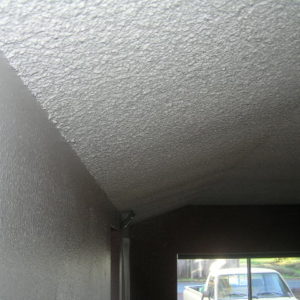

            i posted phots of then inside ....how to take care of this trail home look.. i purchased the house bucause i had lived in it (rented) for 3 years and fell inlove with the location..many of the local builder were salivating at the mouth over this proptery..
            but because i lived there i got the first dibs..and i thanked a local millionire for giv'n me a chance here..get a foot in the door.here are some photos of the roof line inside..(reason for a new roof) thanks
            t
          2. driftwood | Dec 24, 2006 05:10am | #19
            o here are the photos

    Regardless of seaside location you Dozing it is not as simple as Dozing a little house on the prairie somewhere. Coastal Dozing can be fraught with peril, do your research, knock on some local doors that look like they have done the same thing, find out if you can just leave one wall up and doze the rest. Get to know your immediate neighbors and do some serious A** kissing, lift or doze, you will want to do it without lawsuits or nastiness from the neighbors.
    Coastal foundations were typically mixed with beach sand, without the benefit of a fresh water rinse, the salt content over time weakens the foundation, and salt draws more moisture. Your existing foundation could fail under the additional weight of a lift and reno.
    The good news? you are at the beach, no matter how much you spend, over time you will reap a substantial reward. Resort properties done well are always a good investment, whether in the Mountains or on the Coast.

        I love your enthusiasm man, but for heaven's sake think this through.  I've attended the school of no fear on several occasions and the tuition almost cost me my life.  Some tasks are better left to those who do them day in and day out.
        If you're that determined, maybe your local lifter will let you pull some weekends or vacation time w/ his crew to get a better feel for what an enormous undertaking this actually is.

        I would say the 10 g. is pretty good price. You can certainly do it cheaper but I gotta say that having someone else do the lift (assuming they do know what they are doing) is worth it. Those pros can lift it without any sign inside of it ever have been done as long as it started out reasonably level and true. Just having them have the liability is a huge issue. Leaves you 50 g. to do what you are good at and experienced at. Foundation shouldn't cost more than 3 g. even hired out.
        Was the place built in one piece or added onto ? Easiest if all the same building from the start.
        I know one of the county inspectors out there quite well, I will ask him to give me any info on good guys for the lift if he knows of any.

        Do Not Use the RR ties without careful thought and inspection.!!
        If you found a pile of them it is because they were pulled from use because they needed to be replaced because they wouldn't take the weight.
        The pros use the best grade lumber they can find for good reason, they want to live thru the experience.
        Try asking the lifter if there is anything you could do to help out that would reduce the price. (Prep work , disconnection , re-connects any thing at all.) I saved several thou. on one lift doing that .

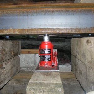

          ....ii actually have a real good friend that lifted 2 houses in alaska...and put new foundations under them...and he is willing to give a hand ,if i help him with his house..really how hard can it be ...its not a huge house at all..i just have to find the steel ..i have the mini excavator and a electric winch for pulling them under.....yea those ties were replaced with concrete in portland i bet i can find 150 good ones thanks for the advise..one thing i know i have to worry about is drift when lifting(keeping is going strait up) ( so you set a couple corner plum pins)..having the right jacks to lift all at once is also a good thing power is supplied from above... septic and water those are real simple..im working on the hardest sand ...the kind you drive on .i will compact the new footing area..if those guys can do it ..i certainly can IF i can find the jack rental....or i bet i could just buy the bottle jacks (airpowered hydraulic)...and still be ahead of the game..i will keep you all posted
          thanks for the insite
          tj

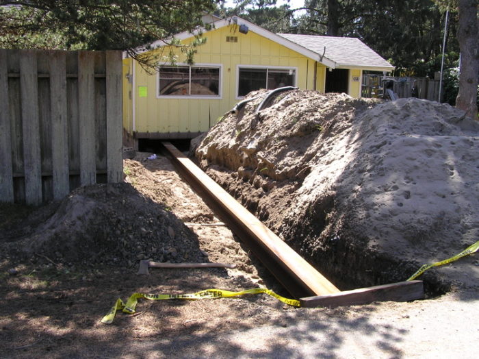

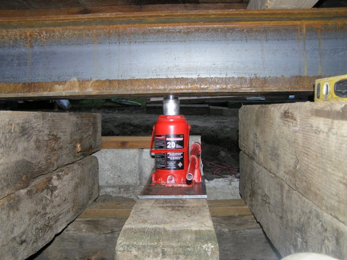

          1. dovetail97128 | Jan 08, 2007 08:02am | #29
            Try Oregon Steel for beams...
            The house movers control "drift" as you call it by having balancing valves and gauges off a central pumping system. They also have quick disconnect hydraulics and check valves at each lift point.The operator watches the pressure to each line and jack that way they get the even lift and don't break things up.
          2. dovetail97128 | Jan 08, 2007 08:07am | #30
            Just caught this comment of yours..
            ""really how hard can it be ""
            Actually Da** hard and dangerous, go very slow, crib often , Every yr somebody dies from thinking just what your comment says about this type work. Last year in Portland is one instance I remember .

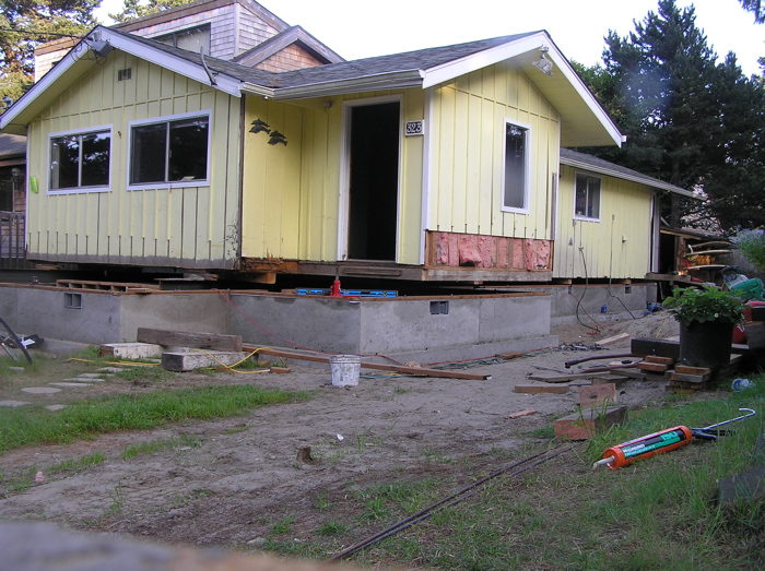

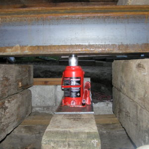

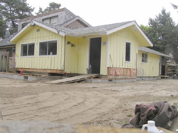

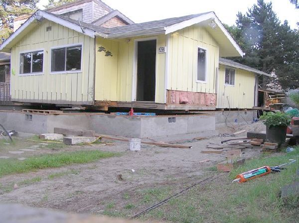

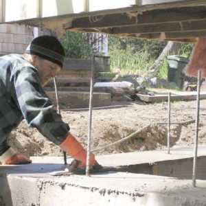

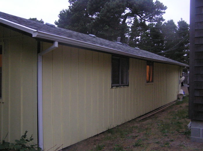

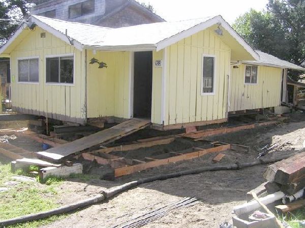

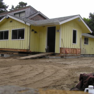

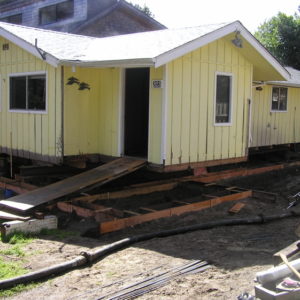

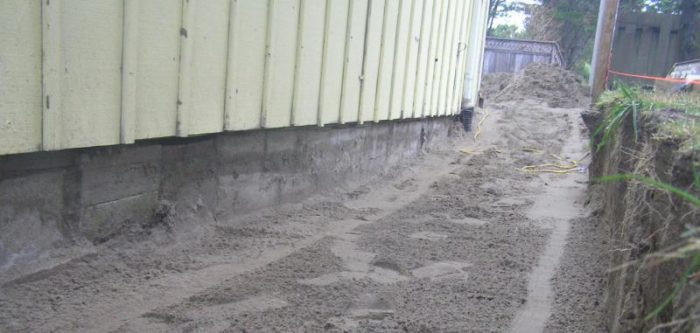

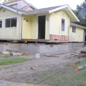

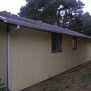

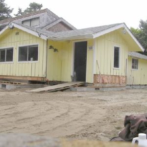

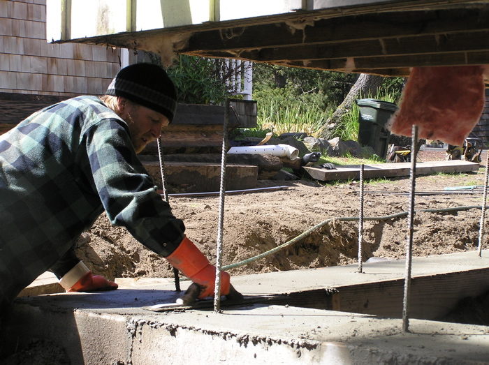

        1. driftwood | Jun 12, 2007 07:31am | #32

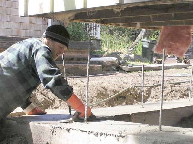

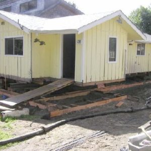

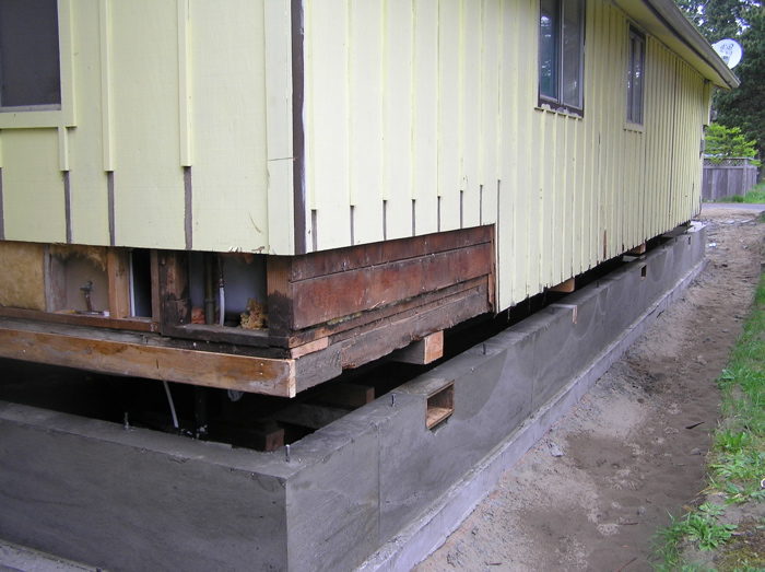

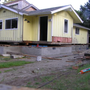

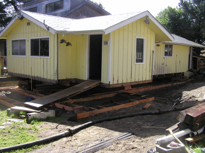

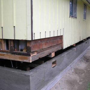

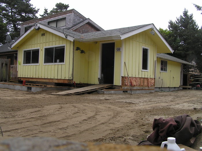

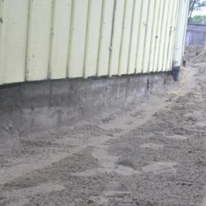

          ok here it is.... its done,and it totally turned out bitch'n and was easy at that...just took a little planning ,time , and patentsall in all it took me 4 weeks to complete by myself..
          were are your friends when you need them to use the D-1 or or what i call a shovel..

          5. driftwood | Jun 12, 2007 05:46pm | #37

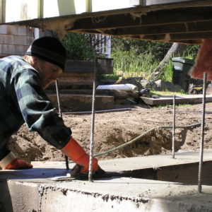

            i will break down the total cost ...no problemexcavation was free, for i traded work with a buddyconcrete 19 yards total @ 100/yrd.....1900.00
            cribbing i got on creigs list .....................30.00
            form panles i traded work for and ended up taking it in the rear on that deal.......
            pump truck for the crete .......................700.00
            87 cubic yards sand ................................66.00(the rock place screwed up on a saturday)
            footer materials ...rebar, panel clips, green plate
            holdowns,nails sill seal ................. 1000.00
            paid a friend for his 2 days of work. 400.00 im guessing the total all said in done.......$4600.00 not counting my time ..
            i havent got the bill for the rented steel beams ...maybe thay forgot about it?a lot cheeper than the 20000 dollar bit i got from the local house lifter
          6. dovetail97128 | Jun 12, 2007 06:09pm | #39
            ddriftwood,
            Very tidy , and nice savings. Do have a question, how the heck did you get away with a single anchor bolt at the corner of the foundation in "done" pic.? Within 12" of ends of sill plates by code. I want to know the secret ;-)"Poor is not the person who has too little, but the person who craves more."...Seneca

            the first reason was that the house was 18 inches lower than the street...causing a huge puddle in my drive with the oregon coastal rains...even though the ground is pure lovly sand it would take hours up to 10 before the puddle sank in the ground..remember the yard is sand making for very easy digging...which i did alot of by hand
            if it were any other type of soil i would not be into it 1 bittotal cost for a pro to do this work was 20K pretty standard...just the lift was 14K
            those house lifter can only do a few jobs a year because of insurance reasons
            if they do more than i think 7 there insurance goes way through the roof..
