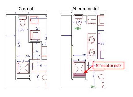

Here’s my question: The shower stall will be 36×48, with the door on the narrower edge. I’ve thought about adding a 10″ wide bench to the back wall for shaving legs, stashing shampoo, etc. Other option would be to put a niche in the wall and corner shelves for storage.
I’ve seen the FHB article on building a shower pan, updating a tub, and the JB article on adding a seat. So, I see the construction techniques.
But I’d appreciate opinions on which is the better way to go, shower seat or corner shelve/niche? Which do you think is more practical, easier on construction?

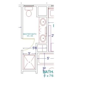

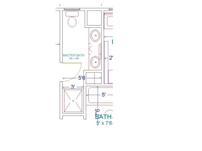

    Oh, and here's a drawing of the MBA
      BillHartmann | Feb 02, 2004 05:44pm | #2
      I can't answer you question, but I saw the layout and have a suggestion.
      If the plumbin allows it what about moving the vanity to the 'top' of the room and putting the linen closet next to the shower. That way the door can open out into the room.
      And you can use a little of the space in that blind corner between the stool and the vanity by putting shelves or a door on it from one side or the other.

      Bill, You lost me.  I'm having a tough time figuring out what you've got in mind.  I would like to have double sinks in the vanity, and minimize replumbing.  I'll have to reroute some supply lines (and the drain for the sinks), but moving the toilet or shower are more than I'd like to do.  Towel rack access from the shower will be poor, admittedly.
      Boris, Thanks for the comments on CBU.  That's sorta what I thought.  Just being lazy here.  As for the bench, my biggest hesitation about putting one in is that the shower is relatively small at 36x48.  Currently, it's a prefab fiberglass unit 36x36 and it feels cramped.  If I put a bench into a 36x48, floor area of course reduces down to what I've got now.  At the shoulders, it's bigger and it may not have the cramped feeling.  That's the basis of my question, does the "luxury" of having a bench in the shower outweigh having the added floor area?
        BillHartmann | Feb 02, 2004 07:23pm | #5
        No moving the toliet.
        (direction based on drawing as posted)
        To the right of the toliet you have a linen closet with a door facing the vanity. And a small space (24-32"?) between that closet and the closet where one has to turn 90 degrees to get stuff out the closet.
        What I am suggesting is just moving the vanity up that 24-32". That closet will become "dead space" (almost).
        Then put a linen closet in the new space between the vanity (after is shifted up). And that closet will open out to the room and be easier to access.
        Where the linen closet is now you can make some use of that dead space by having a recessed cabinet or open shelves over the top of the vanity or the top of the toliet or both.
        Now you won't gain full uses of that space, but some.
        As I see it the current "turning space" betweent the closet and the vanity is wasted space and acess to the closet is less than gracefull.
        Edited 2/2/2004 11:26:39 AM ET by Bill Hartmann

            Bill, I had the time to work up the plan you suggested.  Not sure that it makes enough sense though.  As you walk into the bathroom, all you see is wall.  You can't stand back and use the mirror and there's no sense that it's a bathroom.  Practically, it makes some sense, but aesthetically, it seems awkward?  What do you think now that it's on paper?
            BillHartmann | Feb 03, 2004 09:03am | #10
            That is what I was thinking.
            I assume that you are going to put a door on the area to the right of the vanity and make that a linen closet.
          3. Ken | Feb 03, 2004 09:09am | #11
            yep, it would have a door.  What do you think about the "challenges" or considerations I mentioned?  Is it really worth it?  Compromises either way, it's just a matter about which has fewer.
            BillHartmann | Feb 03, 2004 09:38am | #12
            I don't know.
            I don't see any need of having to step back from the mirror.
            But then I hang a black sheet over mine anyway <G>.
