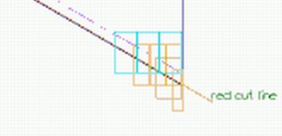

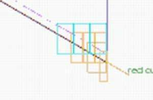

            Pif's pic says it too... the diag line is the cut line..

  2. Piffin | Apr 13, 2006 01:13am | #4
    Assuming cedar shingles, study this
    1. rfreiberg | Apr 13, 2006 01:52am | #6
      Thanks for the pic. It is not too clear, but it looks like you are using the tips of the shingles to build up the layers to the proper thickness, possibly to taper the surface wall singles down to the double-layered starter course on the incline???
      1. Piffin | Apr 13, 2006 04:53am | #8
        right

    You'll have to replace at least three or four courses of shingles to get this right. iF THIS IS A DORMER WITH ONLY 8-9-10 COURSES TO BEGIN WITH, YOU'LL FIND IT EASIER TO REDO THE WHOLE THING THAN FIGHTR WITH THIEFING SHINGLES OUT FROM UNDER SUPERIOR COPURSES.

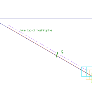

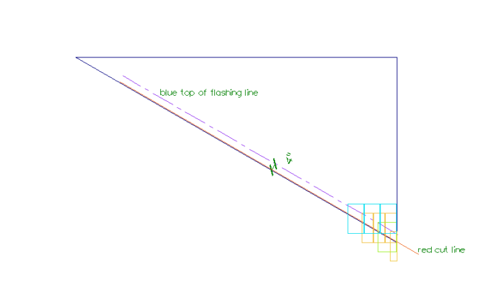

      BTW, is it possible for you to generate that diagram with heavier lines and a bit larger? I can't really pick out the detail.

        1. rfreiberg | Apr 13, 2006 07:17pm | #16
          Got the pic. Thanks. Now these tired old eyes will sit down learn something from it.

      2. Piffin | Apr 14, 2006 05:12am | #18

          1. Piffin | Apr 15, 2006 01:25am | #20
            No, but he asked for a bigger one and that was the original beforee I reformatted for the forum....Can't win'm all
