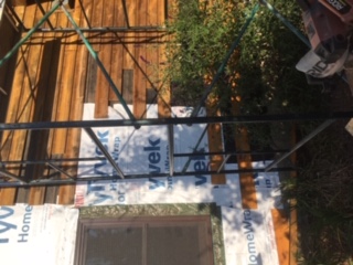

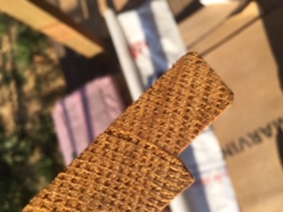

Well, I’m trying to finish a job started by a contractor who was “beyond his prime” and have to reside a portion of this addition. Clad w/ 8″ rabbeted cedar siding called Dolly Varden in our neck of the woods. Original siding was 7 1/4 face w/ 1/2 rabbet leaving a 6 3/4 reveal. It was near impossible to find 7 1/4 from my local suppliers (including the guys that the original came from). Finally located some and was happy as a clam UNTIL I realized the rabbet on my new siding was 3/4 not 1/2. No problem, right? Hold each piece 1/4 proud of the one below instead of setting down on it. Not so easy as it sounds. Any thoughts on a homemade or storebought jig to make this process easier and faster?
